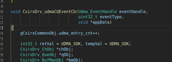

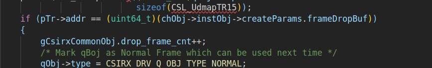

  Since the capture node has no frame rate, we started to debug the underlying driver pdk. In the function CsirxDrv_udmaCQEventCb, we found that it was stuck in the frame loss condition. The data address obtained in the FVID driver is consistent with the data address when the frame is lost. Please help analyze Cause of the problem.
  The following is the judgment when the function CsirxDrv_udmaCQEventCb loses frame. file location in psdk_rtos_auto_j7_06_02_00_21/pdk/packages/ti/drv/csirx/src/csirx_drvUdma.c

    This essentially means that driver is running out of buffers and so dropping the frames. Can you please make sure to provide enough buffers to the CSIRX node?
    Can you also check if any of your node in the chain is running slower?

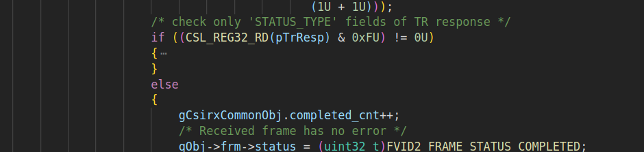

    Which SDK release are you using? Are you seeing any error frames, ie code going under "if ((CSL_REG32_RD(pTrResp) & 0xFU) != 0U)" statement?
