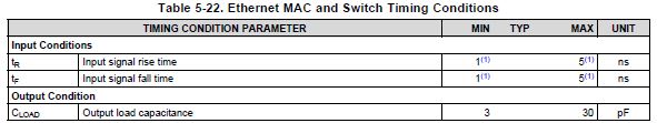

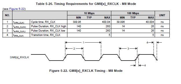

In the datasheet of AM4378, input rise time/fall time and transition of RX_CLK/TX_CLK is found in MAC AC characteristics.
Whether the rise/fall time is measured between 20% to 80%?
