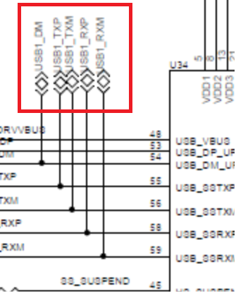

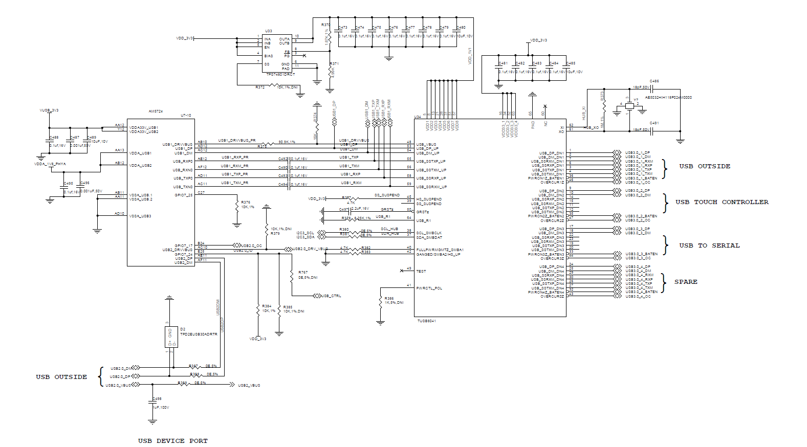

  • Hi praveen,
    Below is the schematic of HUB-
    Trace length on PCB-
    DP-7249 mil
    DN-7235 mil
    TXP-6926 mil
    TXN-6925 mil
    RXP-7034 mil
    RXN-7038 mil
    Vijay
  • Hi Vijay,
    Thanks for the schematic. BTW, this is a new board design? Want to check if you had contacted your TI representative and go the schematics verified?
    If not, we need to get this pass to our h/w apps team to check if there any obvious issue with it? Do let me know.
  • Hi Praveen,
    Thank you for your reply.
    Yes this is new custom board based on AM5728.
    Please check with H/W apps team to resolve this hardware issue.
    Vijay
  • Hi Vijay,
    We suggest you to contact the team who designed the customer board and check if they verified the USB schematics.
    In the interim, I will ask our h/w apps to give their feedback.

  • Hi Vijay,
    Nothing looks amiss on the USB data lines.  I'd like to see the layout to detect any routing issues.  And where are these signals going?  Are they probe points?  Again, a layout would help.
    Also, double check that the USB_VBUS pad on the HUB is around 0.5V.
    I'm not the HW Applications expert for the Hub, and it might help to contact that person and get their input, but looking at the non-data pins of the upstream connection:
    GRSTz:  Connected to ground with a capacitor.  The hub datasheet says "There is no power-on relationship between VDD33 and VDD unless GRSTz is only connected to a capacitor to GND. Then VDD must be stable minimum of 10 μs before the VDD33"  And I don't see from your schematic if or how this would happen at power up.  It looks like VDD_3V3 is powering the VDD_1V1 regulator.  Have you confirmed the power on sequence with a scope?
    USB_R1: Connected to ground with an 8.25K resistor.  The hub datasheet says "Precision resistor reference. A 9.53-kΩ ±1% resistor should be connected between USB_R1 and GND."  The customer could swap this resistor out for a 9.53kΩ ±1% resistor and see if that helps.
    In summary:
    1) The USB data lines look okay, but seeing the full layout is necessary to know for sure.
    2) Confirm that the USB_VBUS pad on the HUB is around 0.5V.
    3) Confirm that VDD_1V1 is stable 10us before VDD_3V3.
    4) If possible, try swapping out the USB_R1 resistor for a 9.53-kΩ ±1% resistor.
    Zack

  • Vijay,
    It looks like you thoroughly tried all of my suggestions.  The next thing I would like to do is review the layout.  You said:
    "Those marked signals are going to a connector where i can check USB 3.0 interface"
    Are the signals creating stubs?  What sort of connector is it?
    A few more requests:
    You say that HUB enumeration is intermittent, and that when the HUB does enumerate, the failure will occur when you plug in devices.  Does the setup ever enumerate the HUB and all the devices correctly?
    How many boards have you tested?  If you have tested multiple, Does failure rate vary between boards?  Do you find any boards that pass consistently?
    -Zack

  • Hi Vijay,
    After an initial review, I have a few more questions:
    1) To reiterate the question above, I'd like to see the layers that show the connector between the SoC and the hub, indicated in this part of the schematic:
    I'd like to see what this feature looks like in your layout.  Providing us with the full board design files would help us greatly.
    Additional questions that came up during review:
    2) I'm assuming that CP2108 and the Touch Controller are USB devices soldered onto the board, correct?  And that the last downstream device is the connector?  Try powering on the board with and the mouse plugged into the connector, and note the frequency with which the Hub fails to enumerate.  Do the same thing again with the mouse unplugged.  I suspect the issue may be with VBUS, and I want to know what.
    3) On a related note, I'd like to see the full schematics of the busses downstream from the Hub.  What is supplying the VBUS for those connections?
    4) I also want to isolate the SoC to Hub connection.  If you can, try removing all devices downstream of the Hub, and see if the Hub is enumerated.  That will go a long way towards isolating the problem.
    Zack
  • Hi Zack,
    Please find the attached pdf test.pdf
    2) Yes CP2108 and  AR1100(touch controller) are soldered on board.And last downstream port is connector and i am not using 1st downstream port of hub.
    i tried powering the board with mouse connected. Now i will note down the frequency of failure in mouse connected and not connected condition.
    3) Vbus for the downstream port devices is connected using TPS2561ADRC (schematic is in PDf attached)
    4)OK, i will disconnect all the downstream ports and check HUB will be detected continuously.
    How can i use this HUB as USB2.0 hub? only removing connection on RX and TX line will help or any other settings i have to do?
    Vijay
  • Vijay,
    From the pdf you sent, it appears that your layout is creating stubs in the high speed differential pairs, which may be causing the problems.  Close to the hub, each of the data lines are forking, such that one set goes to the hub, and one set goes to the connector.  The lines going to the connector are stubs, which violate the layout guidelines for high speed differential pairs.  Please see this application report: https://www.ti.com/lit/an/spraar7h/spraar7h.pdfTable 4 applies to the SoC you are using.  It states that you can't have any stubs in your design.  You should continue with removing the downstream devices to isolate the issue, but if the Hub is still enumerating intermittently, consider removing the stubs going to the connector.
    -Zack
