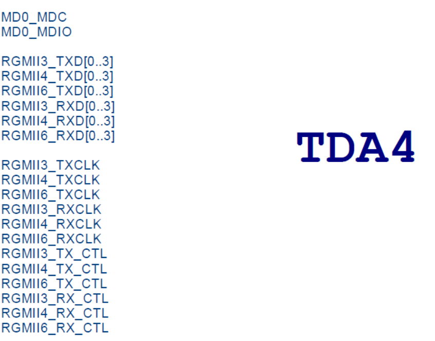

we designed our own boards,so we have to bring-up CPSW9G without the GESI cad.
We connected 3 PHYs to 3, 4 and 6 of RGMII in tda4.
Now we are using psdk-rtos v07.01.00 and we have changed the code.
Now PHY can link up normally,:
14.574775 s: Cpsw_handleLinkUp: Port 4: Link up: 100-Mbps Full-Duplex
Now, port 4 and 6 can be linked up and rgmii 4 works. if we ping PC from tda4 use macport 4, PC can recv the packages and return it back, also mac port 4 can recv its respond.
and we change port 4 to 6 in the case of applying another phy interface ;if we ping PC from tda4 use macport 6, phy can receive the packages but with crc error.
We are appreciated if TI can give us some advice to make mac port 6 work too, and how we can check if there are improper configurations to cause  the failed network connections.
log is here:
