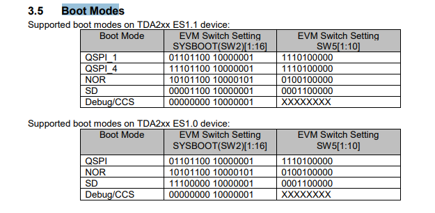

Hello expert
We heard that if the hardware is set with two BOOT modes (SD card and QSPI FLASH), if the SD card of TDA2 is not disabled, there is a small probability that TDA2 will fail to start. I want to confirm whether there are other customers reporting this problem ? Is it necessary to change our current hardware BOOT configuration?
(PS: The TDA2SG hardware BOOT of our current platform is set to sysboot[5:0]=000111, which can be booted from SD card and QSPI FLASH. We hope to achieve the following functions: After mass production, SOC can be booted from QSPI FLASH, and Upgrade the program in QSPI FLASH via SD card)
