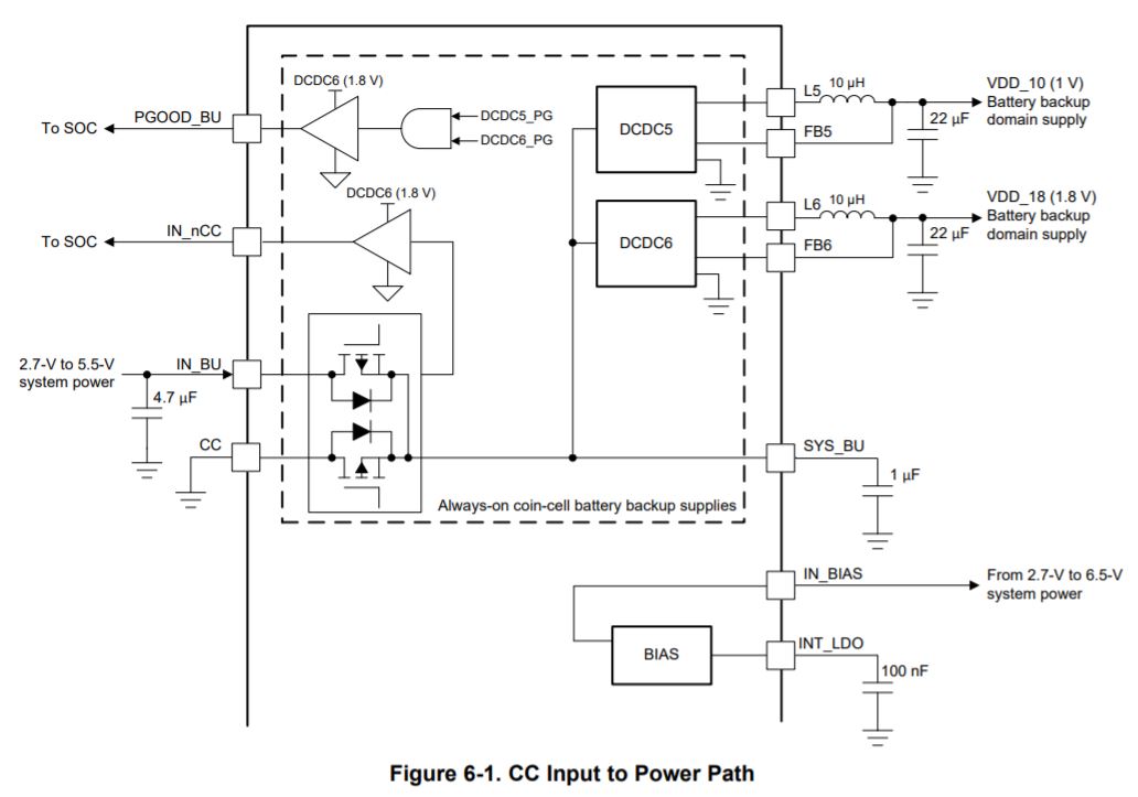

    In TPS65218D0 Datasheet: Applications Without Backup Battery, Figure 6-1 CC Input to Power Path,
    I think the power supply by DCDC5 and DCDC6 will be unnecessary,
    but am I right in thinking that the power circuit by DCDC5 and DCDC6 is still necessary for the power sequence?

  • The TRM clearly defines AM437x connection expectations when the RTC is not used.  See the comment below which was copied from the TRM.
    If your application never uses the RTC functionality, connect RTC_KALDO_ENn to VDDS_RTC, CAP_VDD_RTC to VDD_CORE, and RTC_PWRONRSTn to ground. These connections disable the internal RTC LDO because RTC_KALDO_ENn is high, and they use the external VDD_CORE supply to power the RTC digital core. The RTC LDO must be disabled for internal power sequencing even though the RTC is not used. Grounding the reset signal will ensure the RTC stays in reset. Disabling the internal LDO will allow the application to achieve lower power consumption in all the low power modes.
    Does this answer your question with respect to AM4372 connectivity requirements?

  • I just realized the paragraph in the TRM that describes how to connect RTC when not used, does not include the VDDS_RTC and RTC_WAKEUP pins.
    The RTC Feature Disabled column of Table 2-3 found in the Schematic Checklist provides a more complete list of connection requirements for this use case.
    Paul

  • I sent Ahmad an email asking what he meant in his reply to the E2E post you referenced. I will let you know as soon as I hear from him.
  • He said there was no significant advantage for disabling the RTC.  So he sent this reply trying to encourage customers to keep the RTC enabled since some of them were being confused by what needs to be done to disable the RTC.  It was simpler to leave it enabled.
    He also pointed be to another PMIC document which shows the TPS65216 being used to power AM437x.
    http://www.ti.com/lit/pdf/spruip2
    Paul
