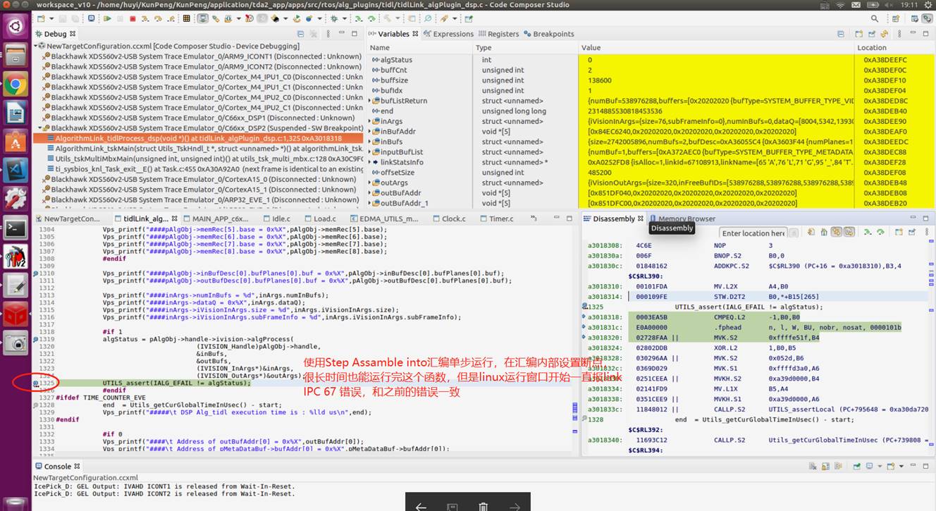

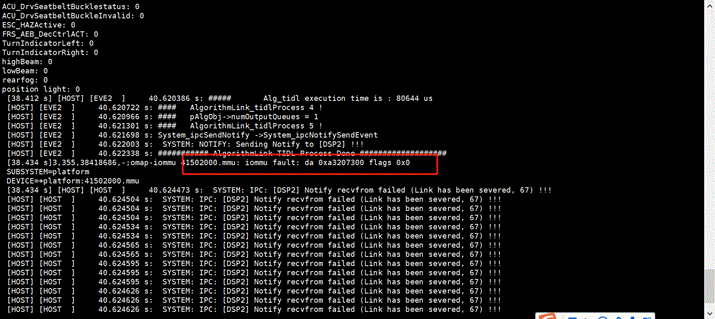

1. We have alreadly ran successfully with hlos usecase(Pushframe(A15) ->Preproc(DSP2)->TIDL(EVE2)->TIDL(DSP2)->result(A15)) on EVM Tda2px platform.
 2. When I debug it on Tda2xx platform for project, then I encounter this link severed error.
With printf functions and skills , actually I have located this issue come from DSP2 process().
Then I ask help from TI FAQ - Yong Zhang, blocked by browser problem, thanks for Yong Zhang, and he helped me to take one ticket on TI forum as above links.
https://e2e.ti.com/support/processors/f/791/t/969015

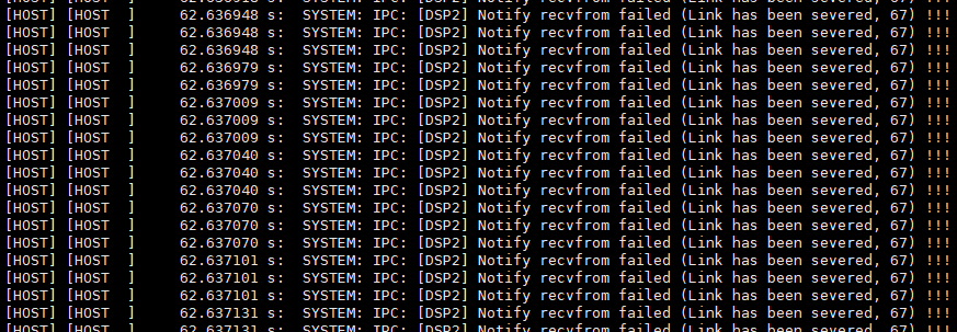

3. Follow  advice fromYong Zhang and Gaviraju Doddabettahalli Bettegowda,I use XDS560 debugger to try as following,
I found algProcess() on DSP2 only can be step into with assembly mode, then we will see link severed error as above.
I think maybe some conflicts between tidl libs and mem config file of project, but we just have no idea to check.

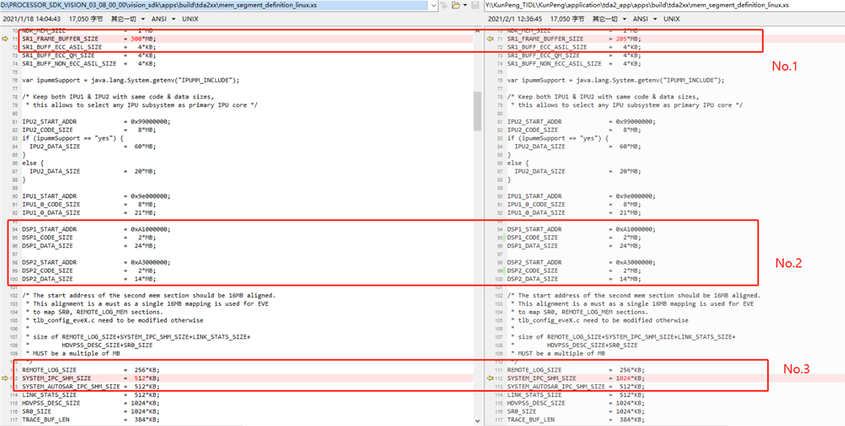

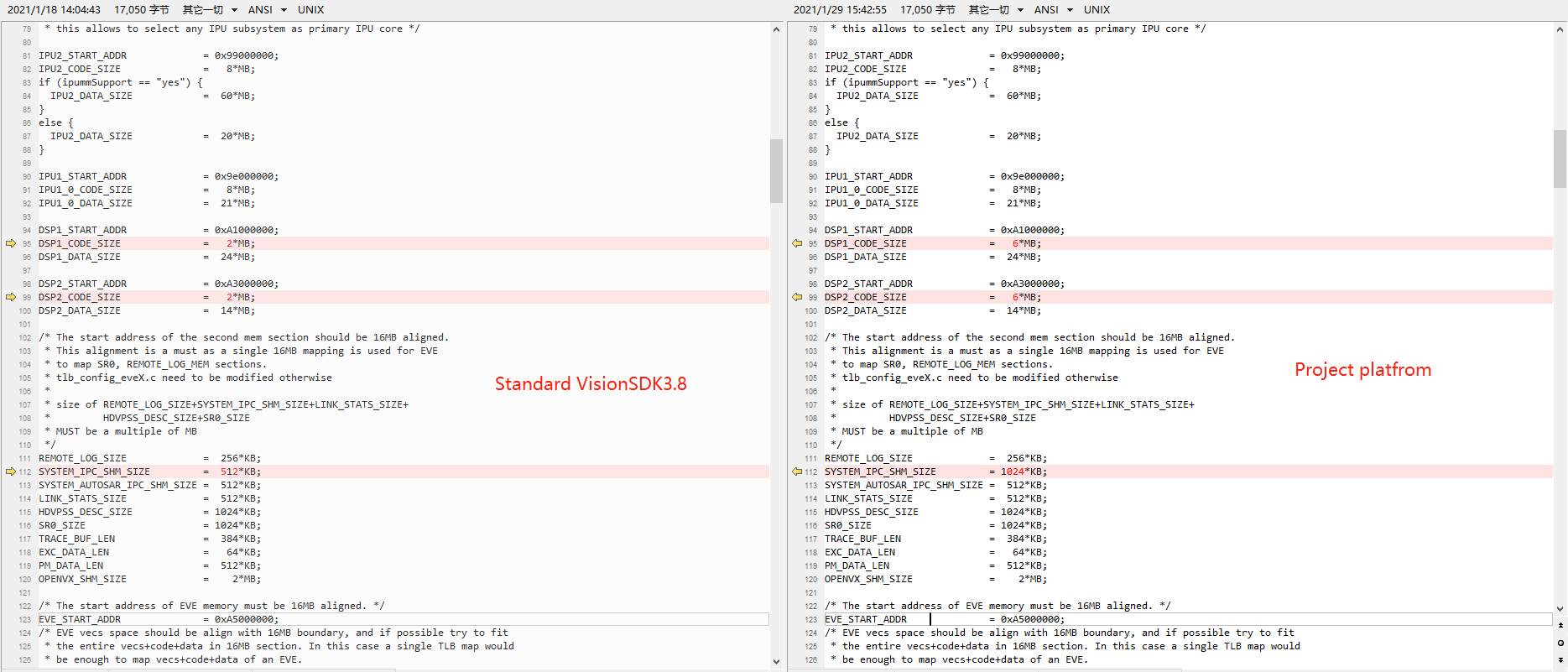

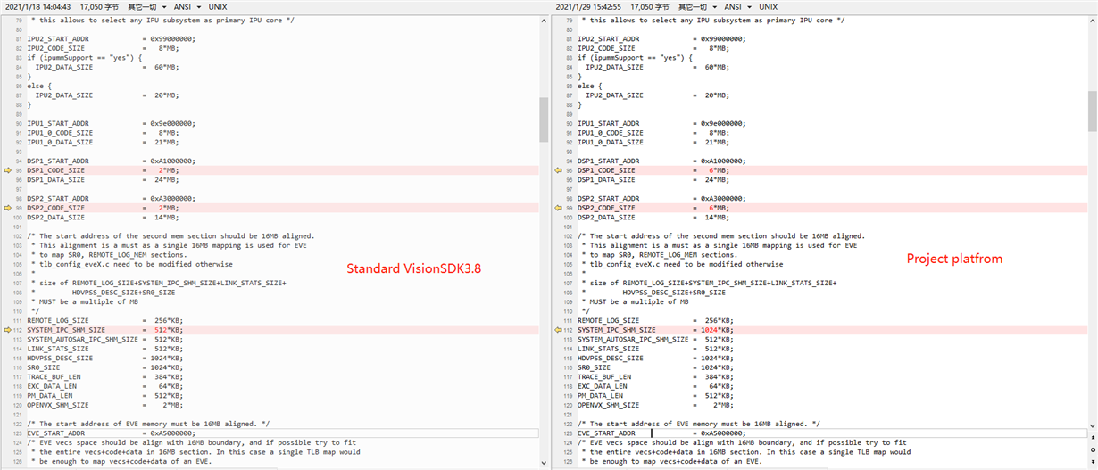

  • From the error message in the log, it indicated that DSP2 generated MMU fault at address 0xA3207300.
    If you compare the DSP2_CODE_SIZE and DSP2_DATA_SIZE between yours and EVM setting, DSP2 total memory (CODE+DATA) is 20MB for your configuration vs 16 MB on EVM.
    There could be additional changes required to increase the total size reserved for DSP2, which lead to MMU fault.
    Can you try reduce DSP2_DATA_SIZE from 14MB to 10MB so the total size remains 16MB and test again?
  • Hello
    Summary as following,
    1. Difference  No.1 come from EVM board with 4 ddrs and tailored project board with only 2 ddrs, so I have no reason to doubt it until now.
    2. Difference No.2, I have followed your advice, keep totally same with left side, both DSP1 and DSP2, result is same error
    3. So I have to check Difference No.3 as above

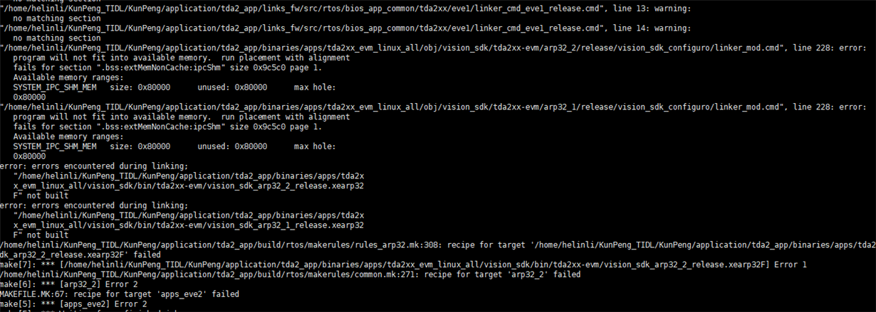

    But when I keep same size SYSTEM_IPC_SHM_SIZE 512KB like left side, and compiled with some error as following,
    I think it should be unnormal, because basic VSDK 3.08 only used 512KB size, can u tell me which part need to check with the compiling error?
    Thanks !
    When you increase the size of some memory section & you should decrease the same size of memory in other section, so have you taken care of this?
    Ex:
    In the above example, I'm trying to increase the size of IPU1_0_DATA_SIZE from 13MB to 13.5MB. The total increased memory size 0.5MB & we need to decrease the 0.5MB memory size in other memory region.
    So here I decreased the size of shared memory size.
    Gaviraju

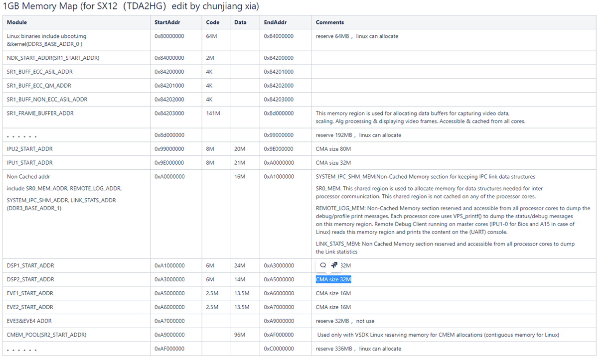

    The table as following, is memory config same of project hardware board, can u find any conflict with TIDL usage? Thanks!
