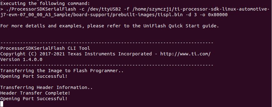

  • Hi Karan,
    Yes CCC characters are sending on MCU UART:
    I successfully flashed TI programmer and SysFW via UART but during attempt to send file to OSPI NOR memory unfortunately without any response from UniFlash:
    UniFlash is stacked (stopped) with this point without positive (either negative) response from UniFlash.

    I checked this with the team got the response:
    "Uniflash depends on the board flash library to provide APIs to access the flash. If customer has board flash library updated to support MT35XU02GCBA1G12-0AUT, changing the OSPI_FLASH_ID in Uniflash ospi header files to MT35XU02GCBA1G12 will make the Uniflash work with new flash device."
