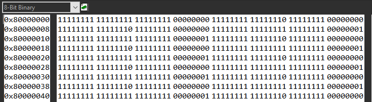

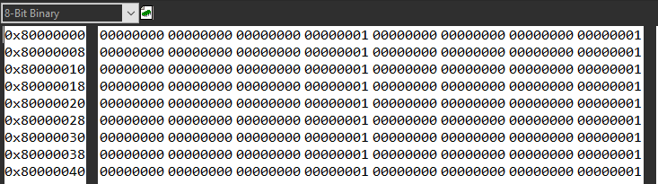

I'm working on a new design using an AM5716 and a single 4Gb DDR3L part #AS4C256M16D3LC-12BCN.  The data is not correct when viewing in the memory browser and I see traces on the data lines that looks incorrect.  While I am sure the SI of this design is not ideal, I think there may be something much bigger that I am still missing.  Perhaps you can spot it!
The write errors follow somewhat of a pattern.  I also get more or less sporadic read errors when viewing it real time during continuous reads.
Fill with 0x00000000
Fill with 0xFFFFFFFF
Fill with 0xAAAAAAAA

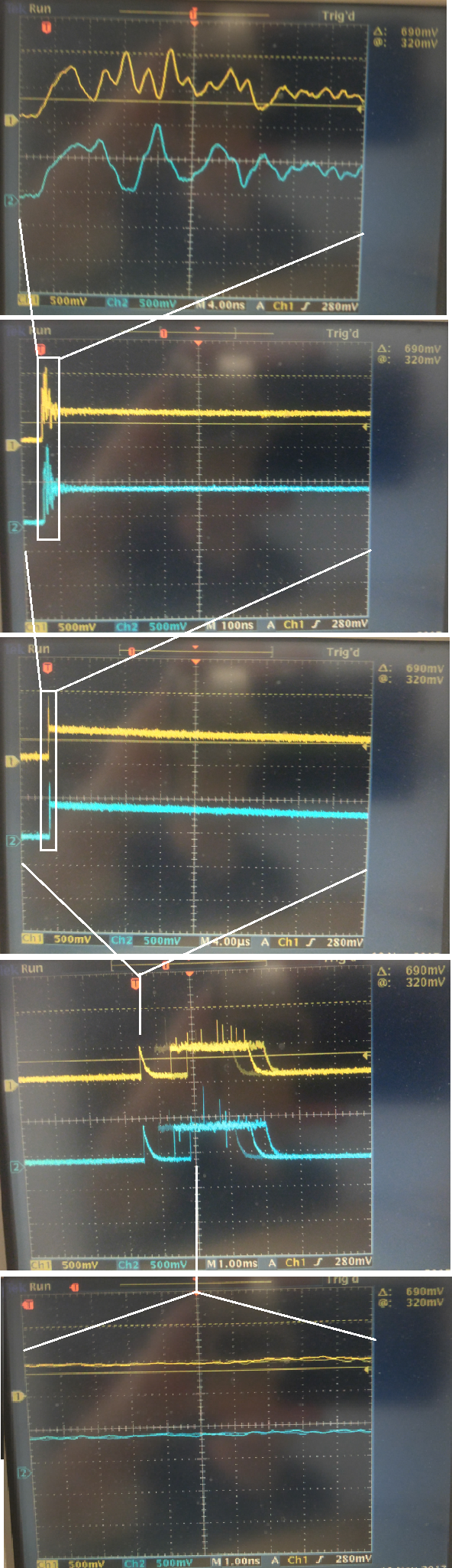

  • Scope Traces!
    Note - I powered the system via a bench supply to set aside any previous noise concerns I had in the upstream power design.

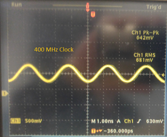

    Clock:
    DQS Signals (ewww):
    A Data line during read / write / and over an extended period of time.
    The view over an extended time looked concerning to me before but perhaps this is normal between commands?  Maybe there is no termination on either side during that time.
    One of the address lines:
    Perhaps this is all just "pretty bad" for a first try at high speed layout. :)  I'm interested to hear your recommendations on next steps and maybe if there is time a chance to review by board design.  Since this might certainly be relevant, the termination resistors are a 43 Ohm array (CAT16-430J8LF - not the 49.9Ohm I show in the schematic).  If by chance my trace layout is not horrible, this can be swapped out easily before resorting to spinning a new board.  Perhaps I should be experimenting with different drive strengths and termination resistances.  As you can see I could use (and appreciate) your advice.
    Thank-you!
    -Jason
  • Hi Jason,
    Thanks for the additional info. The DQS signals look concerning. I may have missed it but I couldn't find the sample rate in the waveforms. I suspect there may still be some under sampling occurring in the DQS and DQ waveforms. How does the DQS signal appear if you match the scope settings used for clock? Also, where are your probe points located (ex: mid-flight, underneath DRAM, etc.)?
    In terms of next steps, we probably need to better understand what is happening with the DQS signal. I'd suggest first trying to recapture the waveform with the scope settings (and same probe) used for clock. If you haven't already, you may also try running IBIS simulations with your board to see how the signal integrity compares to scope measurements.
    Also, a bit of a shot in the dark, but can you try setting the EMIF_PHY_INVERT_CLKOUT to 0x0 (line 600 of your "Dxo_DDR.gel" file)?

  • Hi Kevin,
    A closer look at the DQS0 signal, along with a data signal:
    Below is a series of views at larger time scales to provide a broader view, FWIW:
    At very large time scales, you can see that there is an initial spike or some kind of transfer followed by a much longer transfer.  However, at no point during that time does there appear to be any real activity (the last image is back at 1nSec scale, but in the later transfer section).  I've also noticed that the voltage levels all seem low?  Should the DQS and data signals be transitioning across Vref?  All traces that I've shown in the pictures are referenced to common.

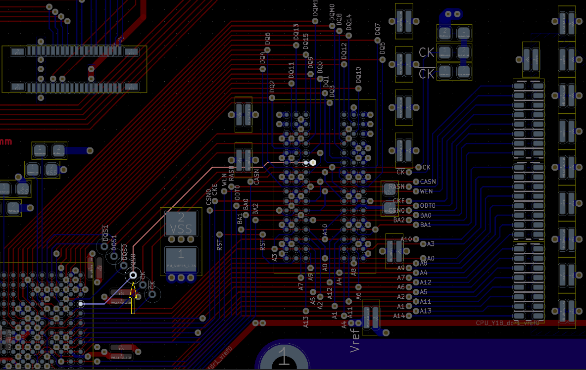

    Sorry for the tangent, but do you have trace lengths for the DQS0/n signals and all the corresponding DQ bits and DM of byte lane 0? I am guessing blue is the  top layer of the PCB. Is red the bottom layer? Mostly asking as the DQ bits look significantly longer than the DQS signals from visual inspection.
    Kevin

  • Hi Kevin,
    I'll report back on the exact lengths.  Blue is the top layer, and red the bottom.  The lengths are probably as different (bad) as they look - length matching is something I overlooked and will need to get right on the next rev.
    Thank-you for the example trace you posted, that is very helpful.
    It looks like the DQS and DQ signals that I see are nowhere near where they should be, and my larger concern is that it can't be explained by improper trace matching...the signals on their own should still be better than what I am seeing.  Something is very suspect about the levels across the board.  If any other thoughts come to mind, let me know.
    -Jason

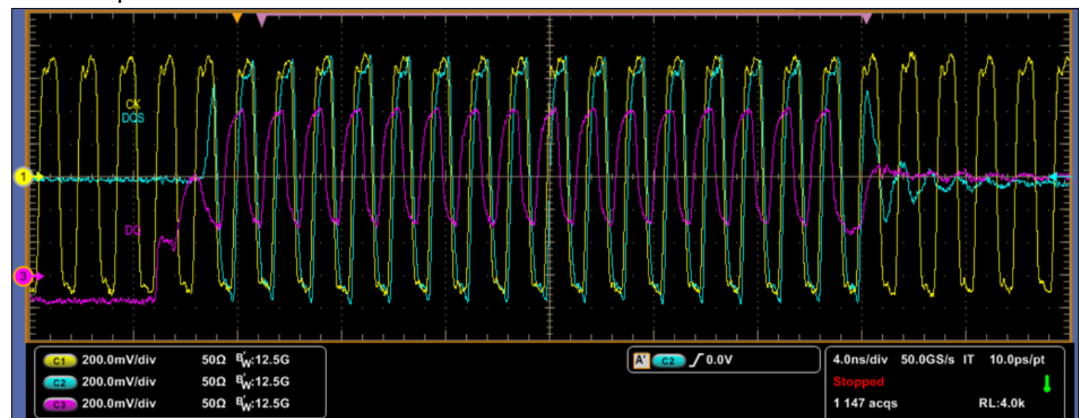

  • I took a few more measurements today, and attempted to capture the *differential* DQS signal like I should have been doing all along.  Using the equipment I have available, I used two probes and the math channel.  I'm happy to report that it looks slightly less horrible than it did before - certainly getting good traces is very much part of the fun here.
    DQS:  I think tPRE is even visible in the first full clock cycle...
    An attempt at getting another trace of a data line.  Still not great - but that could be real or poor measurements.
    -Jason
