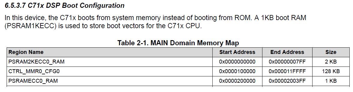

The boot vector is stated to be stored in PSRAM1KECC. However, there is no one with the same name on the memory map as shown below. Based on the size of the area, am I correct in assuming that it is identical to PSRAMECC?
Is there any document or sample that shows what kind of program or data structure should be placed in PSRAM?

  • Hello HaTa,
    I have confirmed with our design team that PSRAMECC0 is the same as PSRAM1KECC.

  • Hi
    According to TRM chapter 6.5.3.7,
       "6.5.3.7 C71x DSP Boot Configuration
       In this device, the C71x boots from system memory instead of booting from ROM. A 1KB boot RAM
       (PSRAM1KECC) is used to store boot vectors for the C71x CPU."
    But, that is all description to "C7x DSP Boot configuration".
    There is no other comment for it.
    What I'd like to know is
       - The boot mechanism of  "the C71x boots from system memory instead of booting from ROM" which is described at ch6.5.3.7
       - What is "boot vectors for the C7x CPU" which is described at ch6.5.3.7
    Thanks and Best regards,
    HaTa
