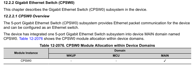

4) Referring to latest TDAVM TRM, the CPSW0 (or CPSW9G) is described as 5 ports instead of 9 ports interface:
Can someone explain the discrepancy?
TI > This is a bug, its 9 ports (8 physical + 1 host port). Thanks for pointing out, we will get it fixed.
