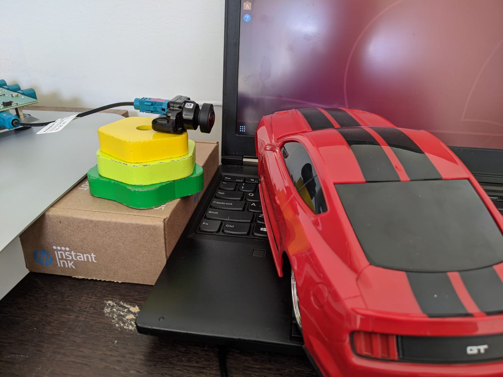

  • Hello Gang,
        I was able to view the live feed on the display with the transformation.But there are a few abberations in the output.
    I have hereby given the camera placement and the corresponding output on display.
    Input 1:
    Output 1:
    Input 2:
    Output 2:
    Input 3:
    Output 3:
    We could see from the above camera placements that the transformation is performed only if the object(toy car) is at a short distance from the camera.
    We observed that with the WarpPerspective,the transformations were happening even at a large distance.Have we missed something in the process of creating the dcc_xml file.
    Please find the values given below:
                4096     // LDC_AB             A(15:0)              Affine Transform warp, A S16Q12
                  0     // LDC_AB                B(31:16)             Affine Transform warp, B S16Q12
                  0     // LDC_CD                C(15:0)              Affine Transform warp, C S16Q3
                  6481  // LDC_CD             D(31:16)             Affine Transform warp, D S16Q12
                  3038  // LDC_EF             E(15:0)              Affine Transform warp, E S16Q12
                  0     // LDC_EF             F(31:16)             Affine Transform warp, F S16Q3
                 -24777396226 // LDC_GH      G(15:0)              Affine Transform warp, G S16Q23
                 -9407437820 // LDC_GH       H(31:16)             Affine Transform warp, H S16Q23
    Vijay
