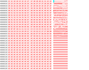

  • Btw,
    I happened to find that when the Y、U and V components of YUV422 are all 0x96(150), the transmission is correct. So I checked the 0-255, when Y、U and V components are the same and all are 81-174, the transmission is completely correct, and other ranges have changed. What is the reason?
    Looking forward to your reply!
    The input YUV422 data will get converted first into YUV444 and then to RGB. So there is conversion involved in the display pipeline, which can change the component values. The lsb bits of the pixel, at max 3, can change the values.
    Do you see only lsb bits changing?
    Brijesh
  • Hi, thank you for your reply!
    I changed the array of YUV422-YUYV in the application program, as follows (the first 256 y components are changed to 0-256, and the other Y, U, V components are filled with 0xae):
    The YUV-NV12 after receiving is as follows:
