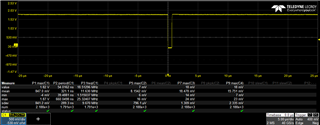

I have set HDMI to Vout1 / DP1 according to the following link, but the clock(pclk) is always about 600 MHz, How to modify it(148.5MHz)?

    Which video port output are you connected to vout1? Accordingly, we can use/change pixel clock for that video port output.

  • Hi, I use VP2 connected to vout1,as following
    For HDMI output, vision apps connects VP2 output to vout0 (DP0) and pixel clock is 148.5MHz. When I switch to Vout1 / DP1 (use VP2), the clock is wrong ,is not 148.5MHz.
    How can I change it?
    But have you changed the pinmux accordingly and measuring clock on correct pin? Because since you are using same VP2 output, PLL will remain same.

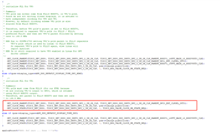

    I'm sure it's changed. My amendment is as follows:
    1、pinmux(vision_apps/utils/misc/src/app_pinmux.c)
    2、appDssDefaultInit (vision_apps/utils/dss/src/app_dss_defaults.c)
    3、According to the above content, the clock will be abnormal (It is different from the following (vision_apps/utils/dss/include/app_dctrl.hconfiguration, but vout0/dp0 is ok).

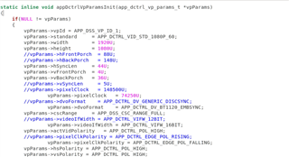

    I wonder if the following (vision_apps/utils/dss/src/app_dss_j721e.c) should be revised as well. If so, can you tell me how to do it.
    Look forward to your reply!

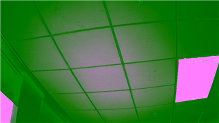

    I can read the value in the register with devmem2 tool. Now I can transfer the picture with bt1120, but the result is wrong,as follow

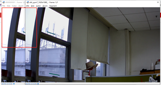

    Original picture(YUV422):
    Picture after transmission:
    The value of the DSS0_VP_CONFIG register is:0x03200000

    · Enable or Disable Color Space Conversion RGB to YUV
    ·Color Space Conversion full or limit range setting
     The results are as follows:
    ·Original picture:
    ·Enable CSC and full range setting
    ·Enable CSC and limit range setting
    ·Disable CSC
    How to locate? Where are the problems?
    look forward to your reply!
    Since you are using BT1120 output, which is YUV422 output over 16bit interface, CSC is must. It must be enabled to convert overlay RGB output to YUV422 format. This is already taken care by driver.
    Also please check what is the expected input sequence for chroma data in your receiver. I thing DSS outputs U first, then V on chroma 8bit output.

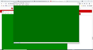

    I've tried to change the endian (big or little), more mistakes after changing.

    I found the reason, Is the difference between the following two parameters:
    ·Source transparency color key
    ·Destination transparency color key
    Thank you very much for your answers!

  • Hi hui wang,
    Depending on the source of the transparency selected, this feature can make color in source as transparent. Please refer to TRM for more details. TRM explains it with the example.
    Do you see greenish picture because of this feature?
    Brijesh
    I tried two configurations, and the second one worked
    1、
    overlayParams.colorKeyEnable = 0;
    overlayParams.colorKeySel = APP_DCTRL_OVERLAY_TRANS_COLOR_DEST;
    2、
    overlayParams.colorKeySel = APP_DCTRL_OVERLAY_TRANS_COLOR_SRC;
    According to the second configuration method, then the green background of the picture is gone.
    Strange, but the color keying is disabled by setting colorkeyenable parameter to 0. So it should not have affected. Can you check in the DSS register if color keying is enabled?

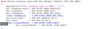

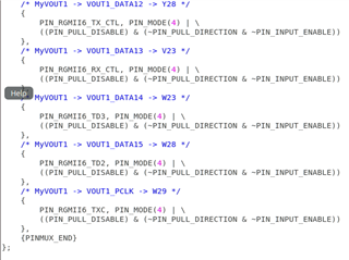

    For other reasons, I need to modify videoport. When I switched to VP4, Vout1 was always problematic. The following is my debugging record:
    1、app_dss_defaults.c
    2、app_dss_j721e.c

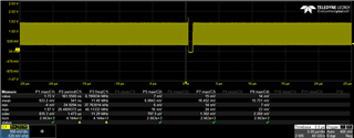

    Because bt1120 will send background information when the system starts, I measured the data lines of two kinds of Vout,  found a phenomenon ,as follow:
    ·data0, data4 and data15 in VOUT0 have data signals, but data2 and data6 in VOUT1 have data signals.
    Is it the above phenomenon that causes Vout1 to be wrong all the time? If so, how to solve it? If not, how to locate the cause of the problem?
    Looking forward to your reply!
  • Hi wang,
    VP and vout are two different things. vout is output signals, whereas VP will generate timings. So changing VP will most likely not change the behavior.
    We need to see why there are incorrect colors in the output.
    When you change output to vout1, can you probe all 16 data lines to confirm they are toggling? In addition, can you check pinmux values of vout1 to confirm it is set for vout1 output?
    Brijesh

    I use the pinmux configured by the ti-pinmux tool, I think there should be no mistakes.

  • Hi wang,
    but these changes are specific to clock, and i guess you are able to setup clock correctly.
    I still have doubt on the pinmux setting. Can you please verify the pinmux settings when usecase is running?

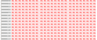

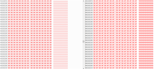

    The result of previous debugging is still problematic, though there is no difference in the naked eye (a picture is bright and a picture is dark). We compared the hexadecimal system and found that the two images (All 0 yuv images) are completely different, as follows:

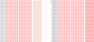

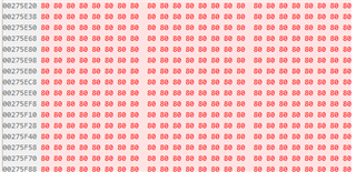

    Y component(The original picture is all 0, and the tda4 transmitter is 42):
    UV component(The original picture is full 0, and the tda4 transmitter becomes 594F):
    The contrast between the two images is as follows(a picture is bright and a picture is dark):
    What has been checked is as follows:
    1、pinmux:all right
    2、gamma correction:disable
    3、color space conversion full range setting: full range setted

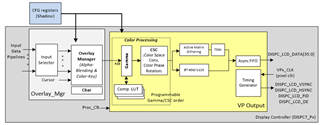

  • Hi wang hui,
    For BT66/BT1120 output, input YUV data first gets converted into RGB and then RGB gets converted into YUV back. These two CSC blocks should be matching to match the output. Could you please check if they are matching?
    This light/dark output cannot be because of pinmux, gamma correction, 16bit output interface.
    Lets check each module in the pipeline to confirm they are matching with the input frame's requirement.
    Brijesh

  • Hi wang,
    No, it is not recommended to skip these transformations. Internally DSS will first convert input YUV422 to RGB and do blending/color keying/transparency operations and then for BT output, it will be converted back into YUV422 format.
    ok, could you please also check if the CSC matrix are matching? if YUV2RGB CSC is for BT601, then RGB2YUV matrix should be for BT601.
    Also are you doing any brightness control? The output value should not change so much, unless these offsets are different.
    Brijesh

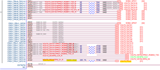

  • Btw, hardware schematic diagram is as follows:
  • Hi wang,
    DSS outputs 20bit data for the BT1120 output format, but you could ignore lower 2 bits in each component and connect 16bits to your encoder. So although i see data0 data output line in the second image, it seems you are connect upper 8bits, so it looks correct.
    Brijesh
    Can you please confirm that the value at the offset 0x04A6023C is 0x00280AFD? If this is the case, the post offset are wrong..
    Other offsets/coefficients for YUV2RGB conversion looks fine.
    Brijesh

    Can't dpi0 be configured in bt.1120-16bit mode?If I can, how can I confirm that I am configuring 16 bit mode? I always thought it was determined by the following(ti-processor-sdk-rtos-j721e-evm-07_02_00_06/vision_apps/utils/dss/src/app_dss_defaults.c) parameters, but later I found that it works on the following configuration.Does this configuration determine the mode of BT(bt1120.16bit or bt1120.20bit)?
    Driver file configuration:
    DSS0_VP_CONTROL Register:
  • Btw, where are the parameters m 、K、Hue configured in the following formula:
    Please dont change output interface width to 16bit. This will reduce RGB888 output from overlay manager to RGB565. Please keep it 24bit output.
    This overlay output will go to CSC for YUV conversion and then BT module to convert it into BT656/1120 output format. And finally it will be output on DPI0 output lines..
    By default, m, k and hue parameters are not configured..

    In hardware connection, I should keep Data0, 1, 2, 3, 4, 5, 6, 7, 10, 11, 12, 13, 14, 15, 16, 17 instead of data2, 3, 4, 5, 6, 7, 8, 9, 12, 13, 14, 15, 16, 17, 18, 19?
  • Hi wang,
    No, if you want to use 16bit, then connect D2 to D9 and D12 to D19 data lines..
    Brijesh

    3、Hardware circuit connection:
    use 16bit, connect D2 to D9 and D12 to D19 data lines

    The register settings look fine. BT1120 and CSC are enabled, DPI is enabled, DPI0 is connected to VP2. it looks to be correct.
    Instead of connecting any video pipeline, can you please just display background color. you could set the background color to 0 and analyze luma output, it should almost 0x0, so all data lines should be low, except when it is transmitting sync codes.. Can you check this?
    Brijesh
  • Hi,  thank you for your reply!
    This is my overlay configuration:
    The oscilloscope detects that there is a signal in Data0、Data4、Data15.
    Received pictures (after YUV422 to nv12), as follows:
    Y component:
    UV component:
    What is the reason?
    all data lines will toggle, because of the SAV and EAV codes. But the received image looks almost black ie when luma has almost 0 value and chrome is 0x80, it is black color.
    So output looks correct.
    Brijesh
    First of all, the input of DSS is a yuv422i-yuyv image with full 0 (Y component and UV component are both 0).
    Then there are three ways to detect the output.
    1、The first one is to use the oscilloscope to check the waveform of 30us (there are about 1080 pixels when the clock is 74.25mhz), and find a lot of non-zero data, as follows:
    Why do 0 and 1 have different trigger waveforms?
    2、With YUV image viewer, it is found that the original image is different from the received image.
    After all 0 pictures are transmitted, the colors are different,as follows:
    As shown below, the color in the red box is different:
    3、Open the file in hexadecimal and find that the Y and UV components have changed after transmission
