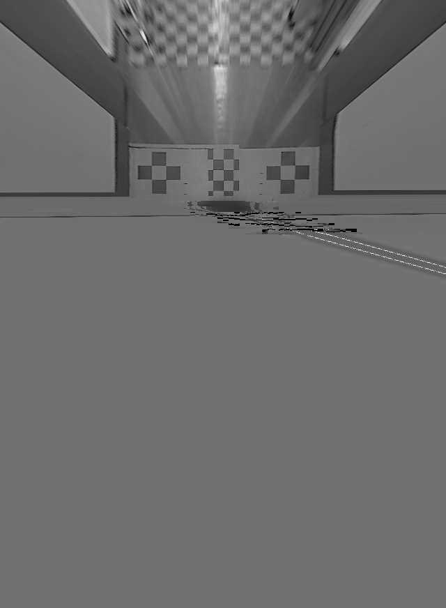

Hi TI,
        we have some problems about TDA4VM  project, please help solve it, thanks!
        We are currently debugging the perspective transformation function of LDC module in VPAC in TDA4VM,SDK version is 7.0
        we also use the openvx interface of VxWarpPerspectiveNode function to verify the correctness of perspective transformation matrix, resulting in the perspective transformation matrix as follows:
         mat[0][0] =  2.1290272602462177e+00;
         mat[0][1] = -4.1308411668024979e-02;
         mat[0][2] = -8.2681922957050295e-05;
         mat[1][0] =  -7.6434047757225043e+00;
         mat[1][1] =  -4.6667823465474383e+00;
         mat[1][2] =  -1.1925750888519777e-02;
         mat[2][0] =  1.7556816975919139e+03;
         mat[2][1] =  1.5900504121366725e+03;
         mat[2][2] =  3.8293676632749518e+00;
         The original drawing we used is as follows:
         We do this by using the vxWarpPerspectiveNode function gets the following result, which gives us what we actually want:
         We place the original matrix inTivxVpacLdcNode too, the output results are as follows:
        It can see, tivxVpacLdcNode seems to be doing only half the perspective transformationAnd only the left and upper half are transformed.My registration process for LDC is as follows

        Please help me locate the cause of the problem, I'm looking forward to your reply, thanks!
