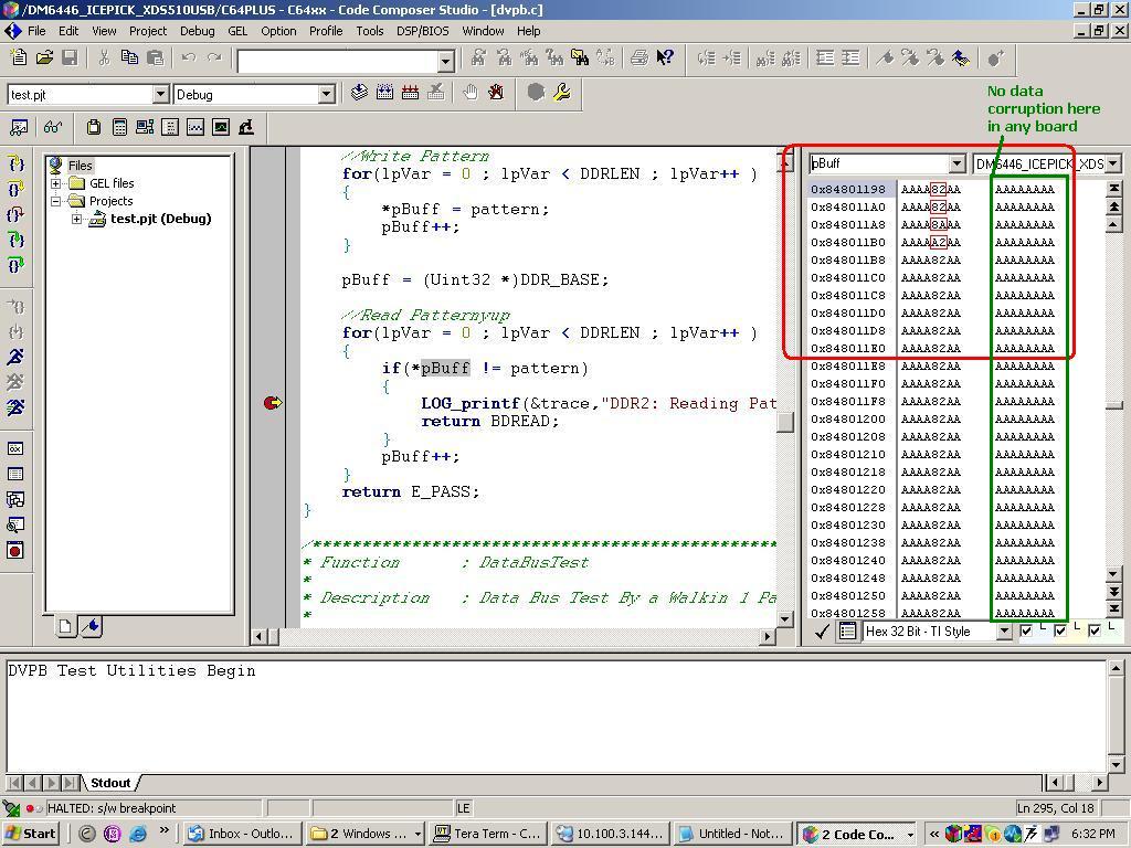

We are facing issue with DDR2 interface, till when silicon changed from "TMS320DM6446ZWT" to "TMS320DM6446AZWT".
Below are our observations for DDR2 issue,
-          Tested DDR2 with CCS utility, which will test full DDR address range.
-          Write known data pattern (AAAA or 5555) to full address range and read back for verification.
-          Observed that (find attached jpg),
o   Data gets corrupted starting from 0x84801198 address onwards (address changed after each power up).
o   Data is corrupted only for odd / even address (for e.g. in attached image all odd address (highlighted with red color boxes) 0x84801199, 0x848011A1, 0x848011A9, 0x848011B1. )
o   Between the two corrupted data there is 8 address byte offset (which is fix all the time)
o   There is no corruption as shown in green color box (in any board)
o   Add significance delay between two write operation, but still the same.
o   When we write known data to any particular corrupted address (directly in memory window), we are able to successfully write/read.
-          Terminate ODT pin of DDR2 chips to GND, but still the same.
There is no DDR issue in 20% of total build of boards of this batch.
Please advice.

  • Here are some questions/comments:
    * Does the value printed by the printf statement match what you see in the memory window always?
    * What is the data type of the pBuff variable?
    * Try changing the Access Size for the DDR region in Options->Memory Map and refreshing the memory.
    * If you slow down the interface and relax the timings does it improve? We can use this information to determine if it is a read or write error. Since the CCS memory window reads back correctly when data is written through there, it would appear that the CPU writes are the ones messing up.
    Jeff
  • Jeff,
    Thanks for your inputs.
    -  Yes, printf statement match with memory window always.
    - pBuff is unsigned int.
    - We changed Access size for the DDR region and observed that, it never fail between (0x80000000 to 0x83FFFFFF, 64MB), but always fail near 0x8400xxxx (failed location is not always the same, but region is same).
    - Slow down the interface from 165MHz to 135MHz and up to 100MHz, but still the same.

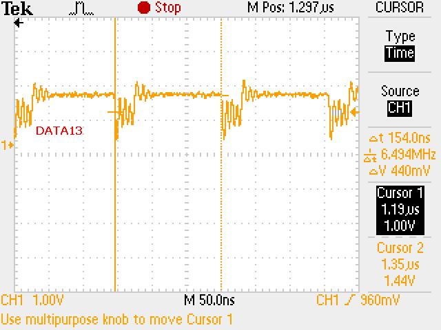

  • dear Jeff,
                   I was puzzled six months by as the same problem, your FAE gave the same advice as you, so I relayouted my PCB and strictly abided TI layout guidance, and I sent my PCB file to your FAE in SHENZHEN to check it, after he checked my PCB layout, I made 10PCS mainboard, but it didn't solve this problem. My PCB layout was layouted by  professional high-speed PCB company, this time is already the second version by  professional high-speed PCB company, so I think this problem wasn't caused by PCB layout.
                  When my DDR2 is K4T1G164QQ-HCF7(DDR-800), if CLK and #CLK are parallel terminating 25pF capacitance to GND respectively, K4T1G164QQ-HCF7 DDR2 on my board can normally work, but K4T1G164QF-BCF7 still doesn't work;
                  when series terminating resistances of CLK and #CLK are replaced with longth 50cm #28 wires, K4T1G164QF-BCF7 can work.  But I don't understand why, can you give me advice for it. How can I solve this problem?
                 Recently, I read JEST79-2F on page 35, it has describe as:'Note that when differential data strobe mode is disabled via the EMR, the complementary pin, #DQS, must be tied externally to VSS through a 20 Ω to 10 kΩ resistor to insure proper operation.  ' Is there problem of the schematic circuit diagram from TI? I studied  MT47H6416BT datasheet,  'DQS is used in a single-ended mode and the DQS# ball is disabled. When disabled, DQS# should be left floating; however, it may be tied to ground via a 20Ω to 10kΩ resistor. ' ;  But  K4T1G164QF and K4T1G164QQ and H5PS1G63EFR-S6C etc. datasheet is that 'Note that when differential data strobe mode is disabled via the EMRS, the complementary pin, DQS, must be tied externally to VSS through a 20 Ω to 10 kΩ resistor to insure proper operation.'

  • Dear Jeff,
                    We have already tried to relax the timings and even slowed down the DDR clock at 47MHz , When we met this problem, but it didn't have any improvement.  I don't modify my board to put #DQS pull downs to made mainboard, because I don't have enough proof.

  • Hi Cui,
                Recently, Tong from Shenzhen TI Office had helped me to look for reason of my problem, but he was no way. He asked me to replace DM6446 with DM6443 from him, and replaced K4T1G164QF-BCF7(6-6-6 800MHz) with K4T1G164QF-BCE6(5-5-5 667MHz), but these didn't slove my problem. So I thought the problem didn't come from chips quality; Tong should be good at software,  so I couldn't doubt soft configuration again, as DDR2 timing really is error; lastly I had to doubt PCB layout and schematic ciucuit, but our PCB layout designer was from professional high speed PCB company, and then DDR2 section of schematic circuit was the same as sechmatic of TI EVM completely. But it don't satisfy a demand from DDR2 datasheet, this demand is below:
             " In differential mode, these timing relationships are measured relative to the crosspoint of DQS and its complement, #DQS. This distinction in timing methods is guaranteed by design and characterization. Note that when differential data strobe mode is disabled via the EMRS, the complementary pin, #DQS, must be tied externally to VSS through a 20 Ω to 10 kΩ resistor to insure proper operation. "
                Whether can you help me to seek that a DDR2 expert will check this point and my PCB? DM6446 isn't in differential mode, but #DQS is float, it don't be tied externlly to VSS though a resistor. I was in trouble for eight months...
