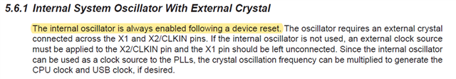

By the way, datasheet section 5.6.1 says the internal oscillator is always enabled after device reset.
If so, Figure 5-16 condition (On-Chip Oscillator Inactive) never happens, correct?

    Sorry for the delayed response.
    The oscillator is always enabled according to the datasheet, 3.5.1 External Bus Selection Register (EBSR). I think Figure 5-16 is showing the case of the X1 oscillator output not being connected to an external crystal.
