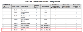

I have a question from my customer about QSPI read cycle.
He is trying to read data from QSPI flash, but read data are 1byte shifted as below.
Written data: 0x00000000, 0x12345678
Read data: 0x00000012, 0x34567800
He checked QSPI waveform and wonders dummy cycles are not aligned between Flash and K2G.
As you can see below waveform, the flash memory send data 8 cycles after address field.
But it seems K2G side takes the 1st read byte 6 cycles after address field.
Register configurations are below.
DUMMY_RD_CYCLES_FLD=0x4 and MODE_BIT_ENABLE_FLD=0x1, so total cycles are 4+2=6 cycles.
Then customer changed DUMMY_RD_CYCLES_FLD, but waveform did not change.
Is there any missing configuration to change dummy cycles?

    What other parameter did the customer set when initializing QSPI?
    Some additional QSPI configuration information about dummy cycles/bytes can be found in the TRM in table 4-10, table 4-24, table 11-3223, and table 11-3304.
    One particular piece of information that I found in table 4-24 is that the number of dummy bytes used when the boot mode is 96MHz is 8.

    There is one correction is previous post.
    For Table 4-10
    QSPI BOOT MODE: 0x8449
    In current setting, COMMAND PIN is 0x2(CMD Value 0x6B).
    This will be changed to 0x4(CMD Value 0xEB)
    It was not correct. Correct configuration is COMMAND PIN = 7, so CMD Value = 0xEB.
    The system boots up with QSPI 96MHz, so Dummy Cycles = 6 clocks for QPI read is selected according to Table 4-10.
    After boot-up, customer changed DUMMY_RD_CLK_CYCLES_FLD, but dummy clock cycle did not change.
    4 clock, 6 clock, 8 clock were tried.
    Are there any reasons why dummy clock cycle is stuck to 6?
    Thanks and regards,
    Koichiro Tashiro
  • Hey Koichiro,
    There is no obvious reason why their changes to the dummy cycle value are not taking effect, it could be a software issue with how they access QSPI. Can you verify if they are directly accessing the memory region associated with QSPI, or if they are using the STIG?
    Sincerely,
    Lucas

  • Hey Koichiro,
    Just to clarify a couple of things:
    - As an FYI, I've never used this device myself but the controller for the QSPI module looks to be similar (if not the same) as the ones in the more recent devices I've used. Looking over the TRM everything seems to translate almost exactly, but I won't be sure of any device nuances that could be present.
    - The reason why the dummy cycles wouldn't have taken effect in the customer's initial question then is because the dummy cycles used by the STIG is in a separate register (QSPI_FLASH_CMD_CTRL_REG it looks like), modifying that with the updated values should have it take effect.
    - DAC, XIP, XIP mode (I'm gonna break down my understanding of each to provide background info)
    • DAC: Basically means the mode where a bus initiator (the A15 or DMA or other core) sends a write or a read to the SoC memory region associated with QSPI. The address accessed in the flash will be based off the offset from the beginning of the SoC memory region.
    • XIP (eXecute-In-Place) : This basically means that a core is executing it's instructions directly from the flash itself by performing read instructions through the DAC interface, without copying over the instructions to internal RAM or a faster memory like DDR. Normally a bootloader would copy over the information from flash into a faster memory, but depending on device definition or customer constraints this is an option around needing other memory.
    • XIP mode: This is a mode that the controller supports and most (not all) flash devices support. This will seem confusing, but XIP mode is NOT required to do XIP, it just increases the performance slightly. This refers to placing the controller AND flash in a mode where only reads are done (since XIP is just doing read instructions to the flash), so the controller will not send the read opcode and the memory will not expect the read opcode; Address and Dummy cycles are still expected. This can be cumbersome as the flash and controller need to be in sync, and to perform any other operation (write, erase, register read/writes), a flash will have an exit sequence to exit out of XIP mode.
    - Now as to why reads/writes through the memory browser are not generating any output signals, (assuming they're using the A15) can you have the customer check their MMU configuration to see if the QSPI memory region is marked as cacheable (likely Write-Back Write Allocate)? The MMU controls properties for the memory regions, if it's marked as WBWA then the write will only go to cache and not go to the actual memory endpoint. One step you can do to more easily check this is ask the customer to temporarily disable the cache and re-run their memory browser test.
    - As far as the register configuration, I would turn off all XIP mode bits (it sounds like the customer hasn't enabled XIP mode on their target memory anyways if they're trying to do writes). Again, XIP mode is not required to do XIP, it just provides a small performance increase (2 cycles of the command opcode saved) at the expense of not being able to do any other operation while in XIP mode.
    Hope this helps!
