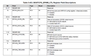

My main problem I can not write into the HRCTL Register to set DELMODE to 2h. Table 11-829 does not say it is protected. Nevertheless I tried to set EPWM_EALLOW bit of EPWM_CTL Register but no success. Can you verify that?
My configuration is attached:

    HW_WR_REG16(0x021D0C32,0x900);
    HW_WR_REG16(0x021D0C34,0x500);
    //Set EALLOW
    HW_WR_REG32(0x021D0C00, 0x438);
    //SETUP EPWM DELMODE to falling edge
    HW_WR_REG16(0x021D0CC0,0x0);
    HW_WR_REG16(0x021D0CC0,0x2);
    //Clear EALLOW
    HW_WR_REG32((CSL_BOOT_CFG_REGS + BOOTCFG_EPWM_CTL_REG_OFFSET), 0x38);
