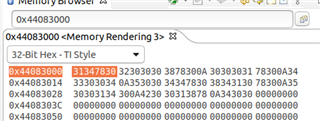

  I think that we can enable and parser the DMSC log via the python script in TDA4, but I still have below questons:
1. In default 7.1 SDK, SD BOOT mode, and we can get the DMSC log as below via minicom:
   and when I dump the trace buffer via ccs, I can find the data as below:
    my question is, why these data are different? Before I thought they should be the same things, just output way is different, correct?
2. I enabled the log output via modify the sciclient_defaultboardcfg.c file, and also build & generate the update h file. my question is, how should I update the binary/lib to SD card while using the SD boot mode?
Thanks a lot!
Br,
Neo

  • Hi Neo,
    So the issue with the boardcfg is resolved but you still want to know why there is a delta between the memory browser and WKUP UART?
    Karan
