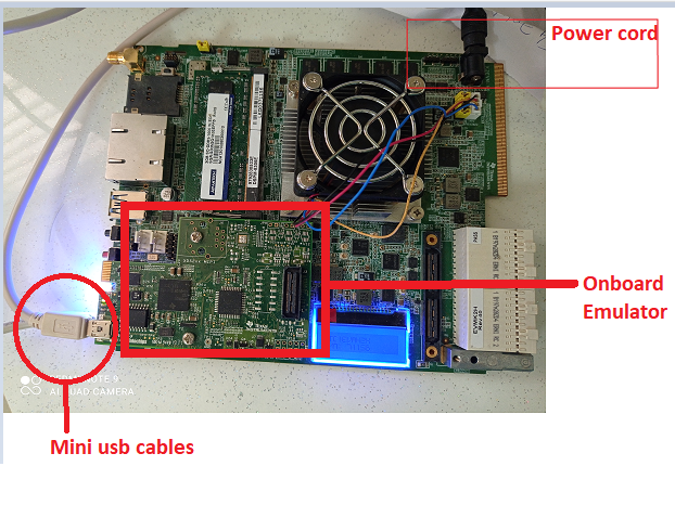

    Step 3: Run the "Platform test " on the C6657 EVM
            In your evmk2h  - board ----> You should put the DIP Switch settings in "No boot mode"  to connect to the CCS.
            That is  ------> DIP SW1 : 0 1 1 1
    Connection details:
    1. Power cord
    2. XDS- Emulator - Mini usb cable between usb port of onboard-emulator of  k2H EVM and PC-running Windows-10
    3. Mini usb between the serial port of K2H EVM and the usb port of PC
    Please follow the video attached and do the steps given below for ease of use.
