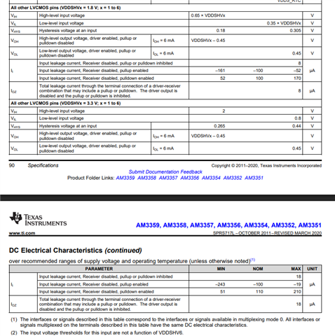

    5.7 DC Electrical Characteristics
    GPIO source/sink current specifications and pullup value (in current)
    We are using the GPMC_A10 GPIO to drive the LDO enable pin.
    AM335x Sitara Processors datasheet (Rev. L)
    www.ti.com/.../am3358.pdf
    Controlling LDO Enable using GPIO (GPIO to drive LDO):
    (+) AM3358: GPMC_A10_ can drive Enable pin of TPS758A01KTTR - Power management forum - Power management - TI E2E support forums
    The AM335x outputs were not designed to support continuous drive of large steady-state current. They were designed to drive CMOS inputs which only requires a transient current to change the signal logic state and potentially a small steady-state current to hold a logic state by over-driving weak pull resistors.
    The datasheet publishes VOH and VOL parameters for the LVCMOS buffer type in the Electrical Characteristics section. These parameters represent the device output voltage for a specific drive current."
    Additional inputs:
    The datasheet publishes VOH and VOL parameters for the LVCMOS buffer type in the Electrical Characteristics section. These parameters represent the device output voltage for a specific drive current. This single data point is all we provide. You would need to use the information provided in the IBIS file to simulation output voltage for any other current.

    Inputs related to enabling pulls for processor IOs
    In case there is a discrepancy between the TRM and processor specific data sheet for the default pull configuration, the recommendation is to follow the data sheet:
    (12) PULLUP OR PULLDOWN TYPE: Denotes the presence of an internal pullup or pulldown resistor. Pullup and pulldown resistors can be enabled or disabled via software
    9.3.1.50 conf__ Register (offset = 800h–A34h)
    Data sheet pin attributes
    IOs that are driven low or high without enabling the internal pulls
    IO that have pulldown enabled after reset
    TRM pad control registers
    (+) AM335x pad register offset info - Processors forum - Processors - TI E2E support forums
    (+) AM3354: There any way to change pad function in userspace? - Processors forum - Processors - TI E2E support forums
