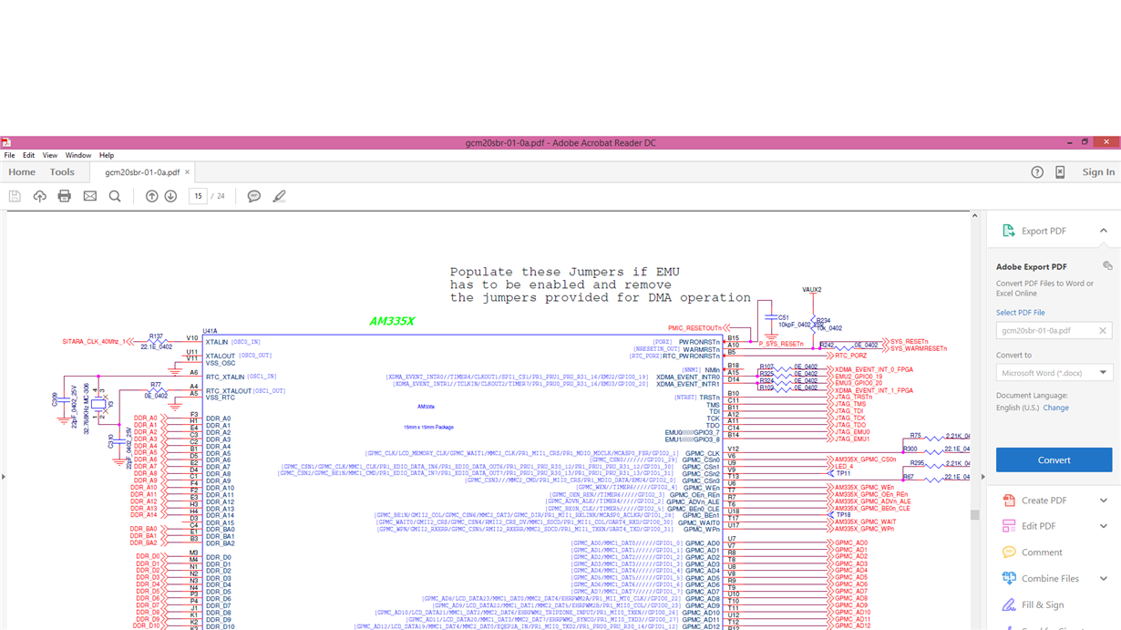

Hi all,
we have developed custom board with am3359 processor. we are not getting CCCC ASCII char printed  on console.
Setting SYSBOOT[5] = 1 will output the system clock on CLKOUT1 we are able to monitor the clock
using Analyzing Boot Issues with CCS and JTAG we are able to test the connection, but when trying to run the script following error is displayed
js:> loadJSFile /home/astra/Downloads/am335x-boot.dss
Error connecting to the target: emulation failure occurred (/home/astra/Downloads/am335x-boot.dss#369)
CortxA8: Error connecting to the target: (Error -2062 @ 0x1851960) Unable to halt device. Reset the device, and retry the operation. If error persists, confirm configuration, power-cycle the board, and/or try more reliable JTAG settings (e.g. lower TCLK). (Emulation package 8.0.27.9)
Thanks in advance.

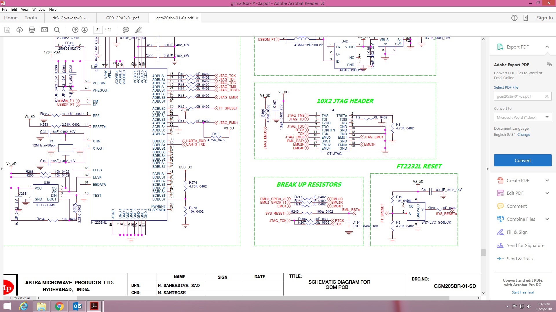

    You should check whether you have external 4.7kOhm pullup resistors to VDDSHV6 on the EMU0 and EMU1 pins. Also you should be aware that the "CCC..." sequence will be printed out only if you have UART0 in your SYSBOOT sequence.
  • Update: We are using USB560 v2 System Trace JTag from Blackhawk (BH-USB-560v2)
  • Hi Biser,
    Our SYSBOOT sequence is according to the Table  26-7. SYSBOOT Configuration Pins in the AM335x TRM
    Both EMU0 and EMU1 are pulled up using 4.7k ohm resistors.
    Thanks.
  • Please post the JTAG portion of the schematic.
  • Please also post your SYSBOOT[15:0] configuration.
  • Hi Biser,
    attaching the jtag connections we are using jtag header ftdi connections are by passed
    SYSBOOT[15:0]  = 0x8021 (1000000000100001)

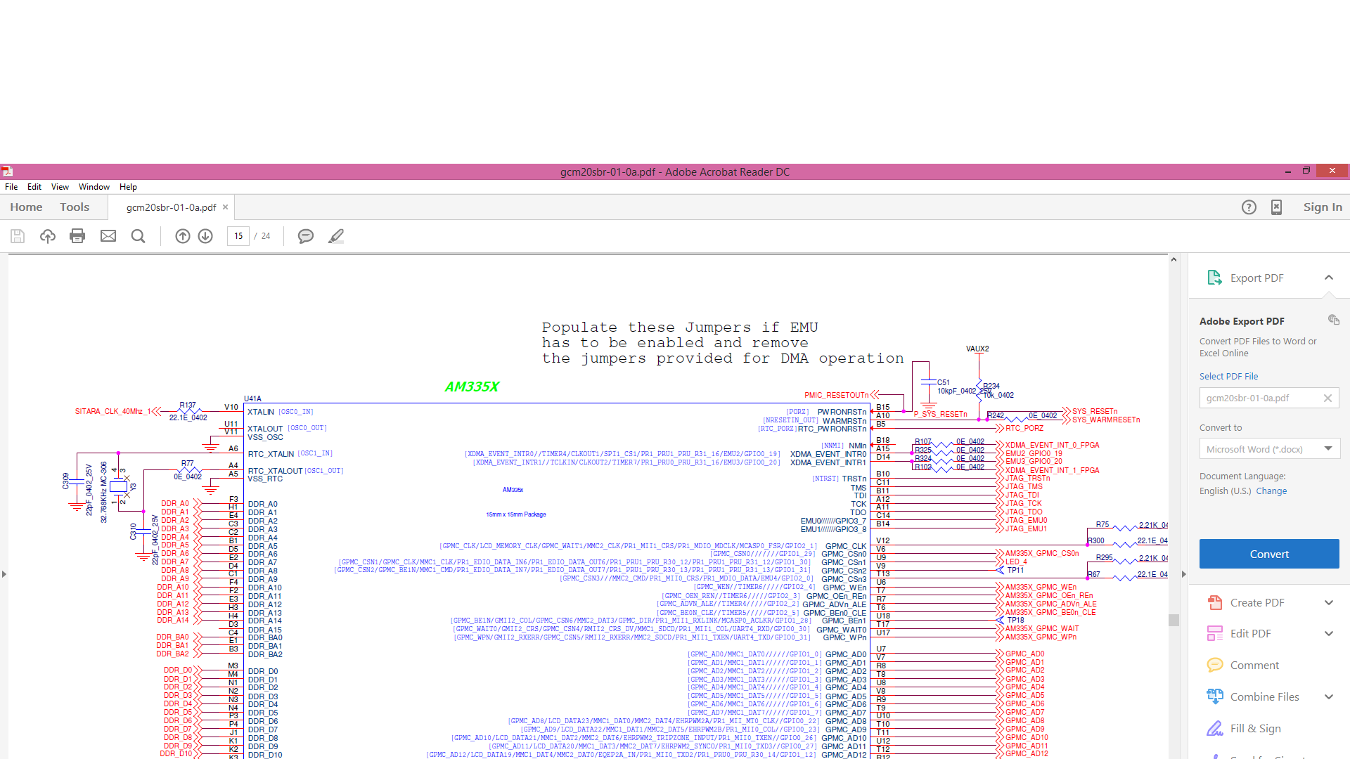

  • Can you also post the JTAG connections on the AM335x side? I don't see JTAG_TRSTn going anywhere.
    On the SYSBOOT settings, are you using a 25MHz crystal?
  • Please check whether JTAG_TRSTn is connected to the JTAG header. I don't see a net label on the header side.
  • S it has been connected using one more header
  • What is your main clock frequency? Please recheck the JTAG_TRSTn signal on the PCB.
  • Dear Biser,
    JTAG_TRSTn pin is connected on different header we are wiring it to JTAG
    my clock frequency is 25MHz and I can see it on CLKOUT1
    My test connection from CCS Is passing using JTAG

    Customer is facing issue on debug AM3359 processor using usb560v2 jtag emulator (custom board). I have attached the schematic FYR.
    Awaiting for early reply.
    Muthu SAstra_Microwave_gcm20sbr-01-0a.pdf
    Your SYSBOOT signals are connected in parallel to the FPGA, the FTDI chip, and a temperature sensor I2C (with pullups to an entirely different power rail). You must ensure that the additional connections are not overriding the SYSBOOT settings at reset release time, which I believe is the case.
