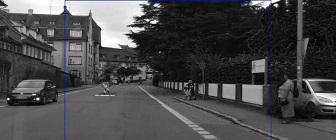

  • Hi Praveen,
    I used jpeg image as a input of markBox.c.
    However, the output PPM file looks like noise, which as attachment shows.

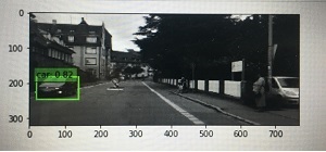

  • Hi Praveen ,
    1. After changing "rawSampleInData = 0", the result is still not correct.
    2. I have also tested another image for comparing the detected results between original trained model and model transferred by import tool. The results are listing below.
    OD model (Original)
    OD model (import tool)
    It  looks like something wrong after transferring by import tool.
    My import file is same as previous one.
    Are there anything wrong with my import settings?
    Can you suggest me how to solve this problem?
    Thank you,
    Gary
  • Hi Gary,
    Is this output with TI model or with your own model ?
    Praveen
  • Hi Praveen,
    Both two results are coming from my own model.
    Gary
  • Hi Gary,
    I tried importing your model shared in the previous post. I see that in your model, for some of the layers weights are not normalized in the training. These weights are causing issue in the import process.
    Can you try to do L1 and L2 regularization on both BatchNorm and conv layers in your model while training.
    Praveen
