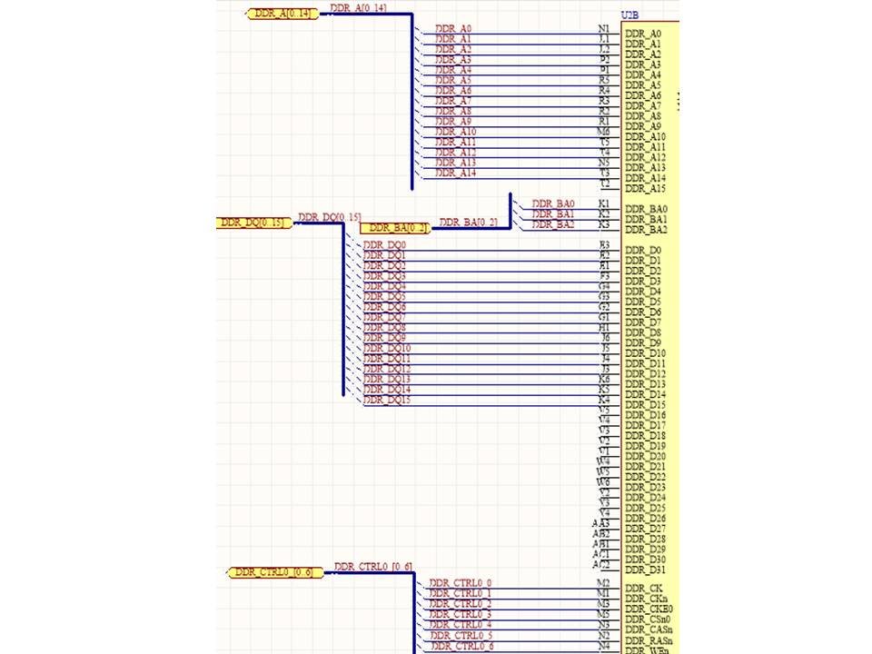

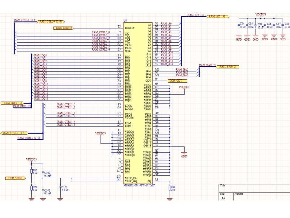

Our company is developing a product based in AM4372. We are having a problem with bringing up u-boot due to a RAM (DDR3) issue. To be more precise, if I run
get_ram_size( (void *)CONFIG_SYS_SDRAM_BASE, CONFIG_MAX_RAM_BANK_SIZE);
the result will always be “0” except if I use
const struct dpll_params gp_evm_dpll_ddr = { 50, 2, 1, -1, 2, -1, -1};
which will return “4”.
We are using a 24MHz crystal, and a MT41K256M16TW-107 XIT RAM memory.

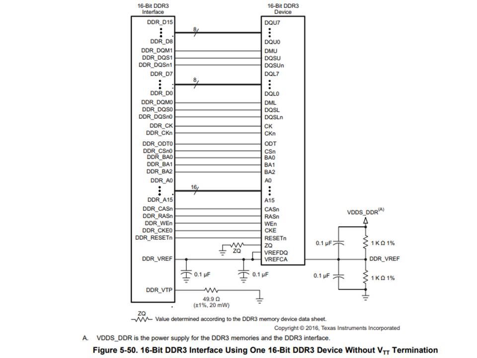

The connection for RAM memory it is according to AM437x Sitara Processors Datasheet, page 172, figure 5.50. 16-Bit DDR3 interface using one 16-Bit DDR3 module without VTT termination (see ConnectionRAM.jpg). This image refers to our schematic design. Please note that R5, R6, R7, R8, R92 and R93 are 1.5k (AM4372-RAM1.jpg, AM4372-RAM2.jpg, SematicRAM.jpg).
Following the instructions in “AM43xx EMIF Tools” documentation, we have compiled the Excel file according the information retrieved from the RAM module datasheet (datasheet.pdf)

    In the original question I formulated I uploaded our schematic electrical design and settings for RAM; can you please give me your opinion about it and our problem?
    Thank you very much in advance, Best regrads!

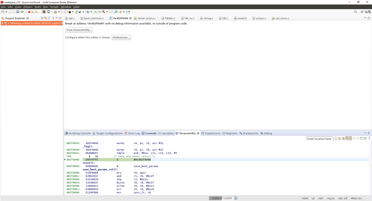

    <debug_uart> spl_early_init
    board_early_init_f
    Timed out in wait_for_event: status=0000
    Check if pads/pull-ups of bus are properly configured
    sdram_init
    get_ram_size
    ram size: 536870912
    U-Boot SPL 2019.01-gc7c7f6afb4-dirty (Sep 09 2020 - 20:26:11 +0200)
    Trying to boot from MMC1
    SPL: Please implement spl_start_uboot() for your board
    SPL: Direct Linux boot not active!
    Hong Guan64 said:
    Another option is to use JTAG debugger to trace/narrow down the issue, especially useful for initial board bring-up. For u-boot symbol relocation when debugging u-boot,
    We did actually do the JTAG of the SPL process and it looked fine. No crash. This is why I have asked if you have any outline of the SPL boot process to have a look "hat is missing.

    I have gone through the entire process and SPL does actually run until the very end. Without excetions or anything strange I am getting up to jump_to_image_no_args:
    I suppose after that he is jumping into main u-boot:
    There is no output on the console and I suppose I am unable to load symbols beause I do not know the offset. Is there any other way to get the offset than "bdinfo" and then "relocaddr"?
    To answer your questions: I am able to run the ddr script at any time with no surprising output. VDCDC3 is 1.35V and VREF is 0.68V, both as expected.
    Peter

  • Hi Hong,
    I do not get there. Once SPL has finished, execution remains here forever:
    Peter
