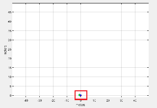

1. In post processing the ADC data collected with Matlab:
a) as the default graph scaling is to coarse for me to analyse the motion. Could you please advise me on how to post process the data with the graph window range zoomed in to +/-0.5m instead of +/-50m. i.e. with a magnification factor of 100
