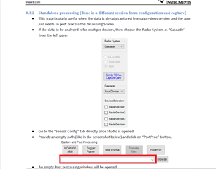

I noticed that I started to have this error whenever I want to capture multiple data separately into 3 or more different bin file.
I have also referred to the following forum pages to see if it could resolve the error I have been facing:
https://e2e.ti.com/support/sensors-group/sensors/f/sensors-forum/704781/mmwave-studio-postproc-error
https://e2e.ti.com/support/sensors-group/sensors/f/sensors-forum/936275/dca1000evm-post-processing-matlab-engine-error
In the DCA1000 Debugging Handbook provided, I don't see the error as mentioned above and/or solution listed inside the debugging handbook.
What I have tried so far but the error persist:
1. Delete the entire RSTD folder located in:
C:\Users\<username>\AppData\Roaming
2. Disable firewall
3. Setting MATLAB Runtime v8.5.1 (32-bit) directory to the highest priority in the Windows "PATH" environment variable
4. Disabled WiFi and tried running mmWave Studio
5. Set the Sampling Rate to 5000 by following the doxygen shown: file:///C:/ti/mmwave_sdk_03_05_00_04/packages/ti/control/mmwavelink/docs/doxygen/html/structrl_profile_cfg__t.html
I have attached the log file here

  • Hello Daniel,
    As a workaround, you could try "standalone post processing". This is particularly useful when the data is already captured from a previous session and the user just needs to post process the data using Studio or in cases when immediate post processing is not available.
    Just follow the steps as highlighted in section 8.2.2 of mmWave_Studio_cascade_user_guide.pdf.
    Ishita

  • Hello Daniel,
    Yes, it works with DCA1000 as well. Just clear the path and click on the "postproc" button. After that follow the same steps as suggested in the user guide to load the log file and bin file.
    Ishita
