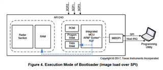

  • Thank you Cesar for your reply,
    However I still have some questions. I start from the beginning.
    I have an AWR1243BOOST that I would configure and use with a SoC ofmy choice. I developed an IP that can for sure communicate with the device AWR1243 as long as the start up occured correctly. CNYS sequence turns IRQ to low and I receive MSSPOWERUP message with the time it took to start up.
    To do this I used the first step of connection tab from mmWave Studio (reset => connect the RS232 => Load BSS => Load MSS). When I probe the SPI signals, I don't see any transfer. I can see after this step that IRQ turns high so I guess the boot up sequence happens correctly and the good behavior with my command/response sequence tends to confirm that.
    Now I want to load the MSS and/or RSS (BSS) from the SoC, to avoid using mmWaveStudio. I don't want to modify anything from your file of course. I read from the document AWR1243 bootloader flow (SWRA561B) that I have multiple possibilities given in section 2.
    First (section 2.1), I can boot from a serial flash device, which I think I could do on AWR1243BOOST because there is a flash device on it.
    Second (section 2.2), I can boot from the FW sent by SPI which is what I want to do. So we no longer use QSPI but SPI I/F. See Fig. 4.
    In Figure 8, the handshake is described and I see that before starting SPI transactions MSS ROM (only ROM) must boot up. So I guess no data is needed for this first part. And it seems SPI is active just after that and can receive commands given in Radar ICD.
    So it comes 2 questions that I asked you in the previous post:
    1) Is the SPI really active at this point (just after ROM)? Because with mmWaveSTUDIO if I don't load BSS and MSS I have to hostIRQ signal turning to high when I probe the signal (or does it require another SOP mode).
    2) If it is active, what is the image to load? Because we agree that only the ROM boot up performed at this point. And in the document, for programming the data flash, it is said that for AWR1243 ES3.0 we must use the metaImage. If not what is the order in which the two separated binary files must be uploaded.
    Thank you for your answer. Please can you provide me with accurate answers for my different questions. In the end I only want to do what is depicted in the Figure 4 above from your document.
    thanks a lot
    The bootloader process (SOP mode) is not the same when mmWave Studio is used, so I would not use it as reference. The firmware used and bootloader flow are different with mmWave studio.
    As you can see in the mmWave Link example, in this example the SOP mode is 4

    Please follow the mmwave_link example
    C:\ti\mmwave_dfp_01_02_06_03\ti\example\mmwavelink_example\ReadMe.txt
    This example loads the firmware through SPI
