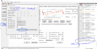

We are having problem with setup DCA1000. I am using DCA1000+AWR1642BOOST and mmwave studio 2.1.1.0
It worked once well. Capturing and transferring bin file was available. However, at some point, there was a problem with the raw data transmission, and after rebooting the radar and capture board, I tried it, but it does not work well.
I think there is a problem with the ethernet connection. The part where the problem occurs when following the quick start menual is the last setup DCA1000EVM part, but the FPGA version cannot be read here. Even if you click Connect in the picture, it just doesn't connect without any message. When I try with the same setting, sometimes it works and sometimes it doesn't, so I think there is no problem with the IP setting or cable connection status. Also, all firewalls were allowed.

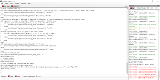

I also tried capture using a lua file to figure out the problem. The error message that occurs as a result of executing the DataCaptureDemo_xWR.lua file after connecting from the Connection section of the figure to RS232 is as follows. The red error message means "cannot fin the file name with 'cf.json'  "

    I have already read the above document and tried some efforts to solve the ethernet connection problem (Can not recognize the FPGA version as shown in first figure of previous thread.). These are the lists I tried.
    1. check the IP
    2. Off all the wi-fis
    3. Allow all firewall
    4. Reflash the FPGA board , we followed section 9 of the DCA1000EVM user guide. (Actually one of the capture board was able to do such job, but one of the capture  board didn't work.)
    5. Tried for 3 laptops, 2 radars,  and another MMwave studio version (2.1.1.0, 2.0.0.2)
    6. Change packet delay to 300us
    However, I still have an aforementioned trouble. Any other suggestion about the issue will be appreciated.

  • Hello Ishita, thank you for your replay.
    These are the answer for you question.
       case 1) We are able to use AWR1642+DCA1000 with mmwave studio 2.0.0.2
       case 2) We are not able to use AWR1642+DCA1000 with mmwave studio 2.1.1.0
       case 3) We are not able to use AWR2243+DCA1000 with mmwave studio 3.0.0.14
    Actually, I think we don't have any problem with wifi or firewalls or loose cables since we tried all the same setting with case 1 (using mmwavestudio 2.0.0.2). We already checked all those issues. (Also we tried to reflash FPGA board accroding to DCA1000EVM userguide)
    We attach the set up picture about above three cases. I hope it could help understanding the errors.
    case 1) AWR1642+DCA1000 with mmwave studio 2.0.0.2 (worked well)
    case 2) AWR1642+DCA1000 with mmwave studio 2.1.1.0 (doesn't work, cannot read FPGA version and different DLL version with case 1)
    case 3) AWR2243+DCA1000 with mmwave studio 3.0.0.14 (Also doesn't work, cannot read FPGA version, same with case 2)
    Additionally, we don't have any problem with other connection settings. We only have the problem with SetupDCA1000 part related to attached pictures.

  • Hello Kyoung Min,
    Thankyou fir your indepth insights.
    In your Case 1 screenshot, I can see that you're using an older version of the DCA1000 FPGA firmware i.e. 2.7.
    The latest DCA1000 FPGA firmware is 2.8. Can you reflash the FPGA with the latest firmware and try again?
    Ishita
