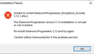

    thanks for your reply. I am always manually selecting the device.
    when i try to use lattice programmer i get this error
    even  though i have lattice diamond 3.12 installed and i have  license too.
    best regards
    resul
  • what could be the reason my board is not recognized by mmwave studio?
  • Hello Resul,
    This is a known issue we've seen with XWR6843AOP devices. The application sometimes does not detect the presence automatically but if chosen manually, it works absolutely fine.
    Regarding your problem with the installation of Lattice Programmer tool, I'm not completely sure of the issue. I personally have not seen this before. You could try uninstalling all the occurrences (if any) of this tool that you may have in your machine and try to get a fresh installation.
    You could also try on a different machine if its possible. If nothing is successful, I'm afraid you will have to contact Lattice Semiconductors directly.
    Ishita
