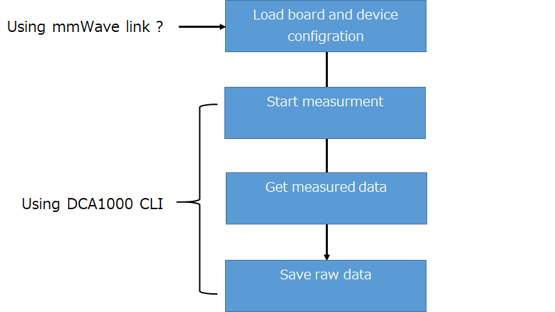

  • Dear Zigang-san;
    Thank you for your information.
    I think that I need to use mmWave link and DCA1000 CLI.
    I would like to confirm my understanding.
    Please see the following flowchart.
    Is this correct?
    B.R.
     Masaaki Sugiyama
  • HI, Masaaki:
    The approach I mentioned is kind of different.   I was suggest to
    1) Run SDK demo code on the target.  the latest SDK release can be downloaded from http://software-dl.ti.com/ra-processors/esd/MMWAVE-SDK/latest/index_FDS.html.   Inside, the SDK demo also call mmwave link layer.   After flashing the binary into the target board, you can send configuration command through UART interface.   And you need to control sensor start or stop through the same UART interface.
    2) Run DCA1000 CLI interface on PC to communicate with DCA1000, let DCA1000 to start capture and saved the captured data into a file.
    I guess you can also come up with your own application instead of using SDK demo, you can use mmwaveLink to control the target.  But I do not have a ready-to-use example for you.   You will need to develop your own solution.
