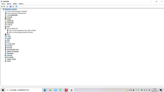

    1.About IWR1843BOOST:

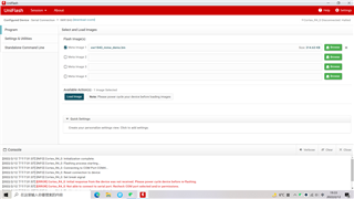

    I am using uniflash(7.1.0) to burn the program and the port cannot be connected. The port is normal in the device manager on my computer, but it shows com4. How can I fix it?
    [2022/2/12 下午7:31:37] [INFO] Cortex_R4_0: Initialization complete.
    [2022/2/12 下午7:31:37] [INFO] Cortex_R4_0: Flashing process starting...
    [2022/2/12 下午7:31:37] [INFO] Cortex_R4_0: Connecting to COM Port COM4...
    [2022/2/12 下午7:31:37] [INFO] Cortex_R4_0: Reset connection to device
    [2022/2/12 下午7:31:37] [INFO] Cortex_R4_0: Set break signal
    [2022/2/12 下午7:31:57] [ERROR] Cortex_R4_0: Initial response from the device was not received. Please power cycle device before re-flashing.
    [2022/2/12 下午7:31:57] [ERROR] Cortex_R4_0: Not able to connect to serial port. Recheck COM port selected and/or permissions.
    [2022/2/12 下午7:31:57] [INFO] Cortex_R4_0: Flashing instance clean-up initiated...
    [2022/2/12 下午7:31:57] [INFO] Cortex_R4_0: Instance deinitialized!

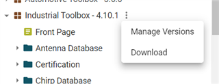

    2.About IWR1642BOOST
    I did not find the file(C:\ti\mmwave_industrial_toolbox_4_10_1\labs\Out_Of_Box_Demo\prebuilt_binaries) corresponding to IWR1642BOOST when I followed the instruction steps to burn the file, which file should I use instead?

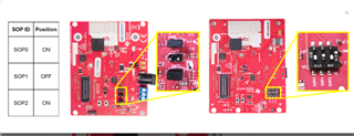

  • Shiyu,
    1) You need to set the SOP switches on the IWR1843BOOST for flashing mode, as follows:
    Please refer to the EVM Setup Operational Modes page to ensure your device is configured for the correct step of the demo process.
    2) You can find the 16xx Out of Box Demo in Industrial Toolbox 4.9.0.  In the TI Resource Explorer, follow these steps:
    Click the three dots next to "Industrial Toolbox - 4.10.1" and then click "Manage Versions."
    Check the box next to the 4.9.0 version.
    Then download 4.9.0.  You will find the out of box demo for 16xx at:
    C:\ti\mmwave_industrial_toolbox_4_9_0\labs\out_of_box_demo\16xx_mmwave_sdk
    Follow the mmw_16xx_user_guide, as the steps to run this version of the demo are different than other EVMs.
    3) Ensure you are pressing the NRST button on the EVM before flashing or making any device configuration changes.
