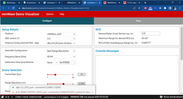

I followed all the steps defined here , unfortunately website is stuck. I am successfully able to flash the device, i switch SOP mode to functional try to send a config, but nothing happens. threads I read through:

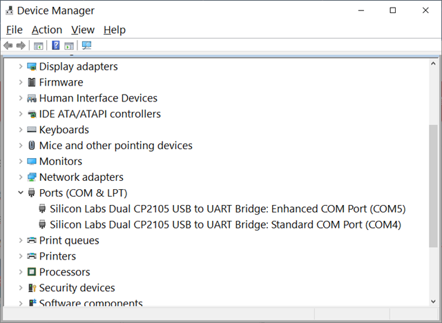

My device manager:

    First I am going to ask you to check that no other applications on your computer are using the data port (an open teraterm window or another window with the demo visualizer up could cause this).
    If nothing else is using your data port, please make sure your device is in functional mode and you pressed the NRST button before trying to send the config file.
    If the problem persists try unplugging your device from power and from the computer and closing out of the demo visualizer. Then plug the device back into the computer and to power (keeping it in functional mode), press the NRST button on the device, pull up the demo visualizer and try connecting again. Sometimes all it needs is a fresh start.

  • No other apps are using the port. The binary is the following:
    C:\ti\mmwave_industrial_toolbox_4_10_1\labs\Area_Scanner\prebuilt_binaries\area_scanner_68xx_demo_aop.bin
    The interesting part that the height demo worked with the device, so it seems like a software issue, i will try using a different computer.

    Can you please try flashing the device with the OOB demo image (mmwave_industrial_toolbox_4_10_1\labs\Out_Of_Box_Demo\prebuilt_binaries) and then try using the demo visualizer. This is the visualizer for our out of box demo not a visualizer for the area scanner demo.
