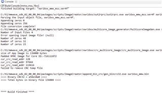

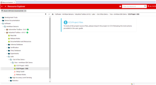

Then I followed this tutorial to compile the out of box demo project in CCS and was getting some errors like the program will not fit into the available memory as shown in

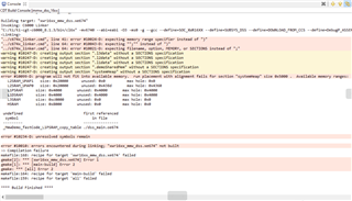

Then in dss_mmw.cfg file, I changed heapMemParams.size to 16*1024 instead of 20*1024.

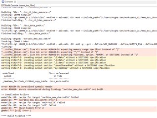

Then it was giving me errors as shown.
So, I changed the dss_main.c [Line 180] extern far COPY_TABLE _MmwDemo_fastCode_L1PSRAM_copy_table;
 to

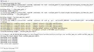

Finally, it was successfully built for both dss and mss as shown.

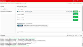

Finally, I tried to flash the program with UniFlash and was successfully able to do that.
