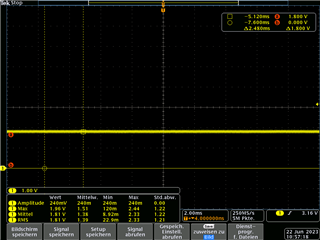

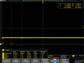

  • B10 VBGAP is approx. 660mV not 900mV as expected
  • A10 APLL, VSYNTH are not 1.4V but only 0.18V - so I expect A14 not to be working either it is at 390mV too low.

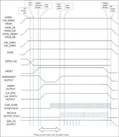

    As you noted, the VBGAP should be 0.9V and not 0.66V; therefore, we can begin further debugging to identify the underlying cause of the problem.  Additionally, make sure the LDOs are functioning properly. I believe the internal LDO may have failed because the probed VOUT_14APLL, SYNTH should read 1.4V. Be sure to probe the 3.3V, 1.2V, 1.0V, 1.8V output supplies to make sure they are operating within the recommended spec limit for power good, This should be fine if you are using PMIC; please double-check. The SOP lines should be stable prior to the NRST release registering the right mode, therefore please verify them as well at the time of reset release (rising edge of NRST). Check that the Warmreset goes from high(1) to low(0) then high(1) within milliseconds at the time of NRST assertion by probing it as well. To identify the cause, you can use the 10 steps listed in Test 3 of the HW bring up instructions. Follow the below wake-up sequencing instructions for proper boot up

    For the supply the recommended PMIC is used in combination with the recommended LDOs. I measured the switch nodes which are clean and checked the output voltages again. There seems to be no ripple present.
    3.3V OUT (DCDC) 1.8V OUT (LDO)
    1.2V OUT (DCDC) 1V OUT1 (LDO)
    1V OUT2 (LDO)
    Best regards
    Steve

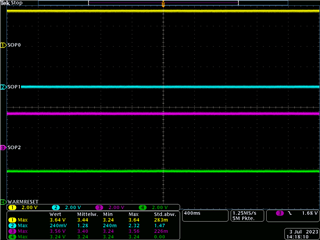

  • Hi Ankit,
    good point - as you mentioned there can be an CCM-R4F NERROROUT issue with some silicon versions - I am using a different board right now and checked again.

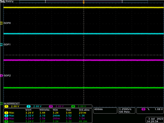

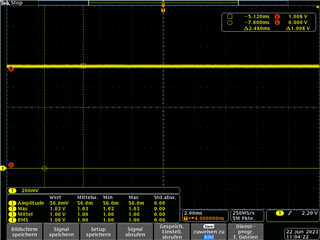

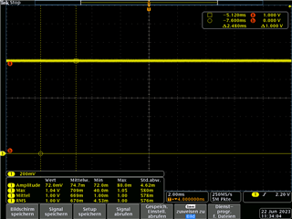

    After applying the supply without any jumpers on the SOP lines - the signals look like this:
    SOP1 is a little low as mentioned 2.3V possibly drawing a litte too much current accross the 10k.

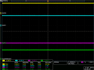

    After pulling SOP2=0V, SOP1=3.3V, SOP0=3.3V with jumpers (Dev Mode)
    or pulling SOP2=3.3V, SOP1=0V, SOP0=3.3V with jumpers (Flash Mode)

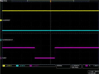

    I tried 4 cases:
    1) no jumpers on the SOPs - power the board - wait a few seconds - set SOP for dev mode - wait few seconds - NRESET toggle
    2) no jumpers on the SOPs - power the board - wait a few seconds - set SOP for flash mode - wait few seconds - NRESET toggle
    3) set SOP jumpers for dev mode - power the board - wait few seconds - NRESET toggle
    4) set SOP jumpers for flash mode - power the board - wait few seconds - NRESET toggle
    As the oscilloscope only has 4 channels I cannot show all signals simultaneously - but in any of the 4 cases a toggling of NRESET does not affect WARMRESET as shown below.
    As you can see, WARMRESET stays high constantly as well as NERROROUT. The latter indicating there is no critical error regarding the R4F.
    As soon as possible I will try to cross check the bahavior with a different board.
    Best regards
    Stefan

  • Hey Ankit,
    I found an issue in the 1.8V supply rail: some pads were isolated from the rail thus not all voltages were at expected states resulting in the chip not issuing WARMRESET.
    - SOLVED -
    Thanks for your support.
    By the way: there seems to be an inconsistency in the Hardware Bringup Guide / Design Checklist: T3-6 VBGAP voltage check should be a step after the T3.8 WARMRESET voltage check. VBGAP will come up to ~900mV while WARMRESET is in progress as seen below. So measuring VBGAP before WARMRESET is issued will lead to a incorrectly measured VBGAP voltage.
