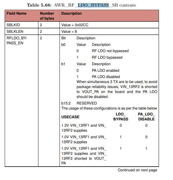

    I have done some more research on the LDO bypass and PA  LDO disable settings. It appears these can be configured using mmwave studio, but before I do so I want to make sure I don't damage my EVM. There are some warnings concerning setting these configurations and that they may damage the EVM, however it appears that in order to properly use all 3 Tx antenna simultaneously the bypass must be enabled. If I power my EVM board via the test points TP12 and TP13 with a 5V 3A supply and enable the bypass, will this be sufficient to provide enough power for all 3 Tx, or will it damage my board?
    Thank you,
    Christian

  • Christian,
        Current EVMs on hardware configuration comes with internal LDO bypass option taken into consideration. That is, PMIC/DCDC provides 1V input at the LDO inputs, Hence in the mmWave studio or SDK internal LDOs are bypassed so that 1V would be directly fed to RF circuits. Concern is only during 1.3V being fed to LDO input and internal LDOs are bypassed, then 1.3V will be directly would be fed to RF circuits.
    Hence you could use all 3 Tx simultaneously to increase the range of the Radar. There is no concern of EVM getting damaged with the same default configuration.
    Thanks and regards,
    CHETHAN KUMAR Y.B.

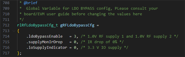

    Thank you for your response that was very helpful! However, now I have ran into another problem. In the mss_main.c file located in the directory,
    C:\ti\mmwave_sdk_03_06_00_00-LTS\packages\ti\demo\xwr68xx\mmw\mss
    I found a line of code to enable the LDO bypass
    I set the .ldoBypassEnable line equal to 3 which should enable the LDO bypass and disable the PA LDO which seems to be what I want according to the mmWave Radar Interface Control Document
    I then rebuilt the binaries and flashed the board via UNIFLASH, but now I am experiencing some strange behavior. Connecting the board to TI's Demo Visualizer works fine, I am able to send my custom config and observe data on the plots, but when I try to send my custom config via my python script, it doesn't seem to be working and I receive no radar data (this script was running perfectly fine before I made this change in the mss_main.c and reflashed the board). I also noticed that the D7 LED is illuminated extremely dimly when pressing the reset button and does not illuminate at all whilst running my python script, however when running on the Demo Visualizer the LED shines brightly as it should. Do you have any insight as to what is happening? Is there something I might have missed?
    Thank you,
    Christian

  • Christian,
         It appears your configurations are correct for the LDO bypass.
    Thanks and regards,
    CHETHAN KUMAR Y.B.
