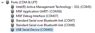

    At this point, my device manager recognizes and assigns MSP Application UART1 and MSP Debug Interface to COM6 and COM5, respectively, and a new device is listed under the Human Interface Devices section of device manager as HID-compliant vendor-defined device

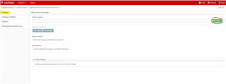

    Could you try using TI UniFlash to upload the TDC7200EVM Firmware to see if this works for you?
    UniFlash should automatically detect the Launchpad board if all the drivers were successfully installed. Once the Launchpad is detected, press the 'Start' button, shown below:
    Once there, under the 'Program' tab, highlighted below, select  'Browse'. Next, go to where the .txt file for the MSP430 firmware and select that.

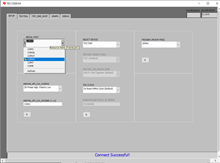

    Once the firmware file has been selected press 'Load Image' to upload the firmware to the MSP430. After this has been completed, you should be able to open up the GUI and select the TDC7200 under Select Device. Finally, use the drop-down menu under Serial Port to select the correct serial port connection, for me that was COM43, and press 'Connect'.
    Hope this helps!

    I installed the UniFlash program, the program identified my MSP430F5529LP, and I attempted to verify the firmware. During verification of the FW, an error occurred. This is the following error message:
    1/25/2024, 12:37:36 PM] [ERROR] MSP430: File Loader: Verification failed: Values at address 0x04400 do not match Please verify target memory and memory map.
    Disregarding the error, I was able to successfully upload the FW onto the MSP-LP, and subsequently updated the USB serial device listing in my device manager, using the TDC7200 FW driver package.

  • Just wanted to provide a final update for any future users that may encounter this issue.
    I was able to successfully install and update everything necessary for the TDC7200EVM to function correctly, and I verified the correct functionality using a 2-channel function generator. I am using the following settings:
    Alicia, thanks again for the assistance. You are a rockstar!
