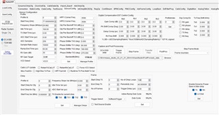

In the SensorConfig tab of mmWave Studio, I set the following:
1. However, Tx3 cannot be displayed in the ChirpManager and ProManaget windows. There are only Tx0 to Tx2.
2. And in Phase Shifter, I set Tx0 0 deg., Tx1 90 deg., Tx2 180 deg. and Tx3 270 deg., but it doesn't seem to work.
The spectrum when set like that is as follows.
Please tell me how to solve this problem.
    It is a known issue in the studio. But, with the manual 'set' button you will still be able to configure the chirp as you want.
    This heatmap shows you distance vs velocity comparison for non-static/moving things. If the device is static and there is nothing moving in front of it, then you won't be able to see any deviation in the heatmap.

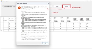

    1. However, Tx3 does not appear in ‘Manage Profile’.
    2. When I press the ‘Activate’ button, the following error occurs.
    3. When I click the 'Set' button and open the 'Manage Chirps' in the 'Chirp' frame, I still do not see the Tx3 settings (Only Tx0~Tx2)..
    4. And when I click 'Activate' in the 'Manage Chirps' window, I still get the error same as 'Manage Profile' window.
    5. I checked the chirp information of the acquisition data from DCA1000, but Tx3 information is still invisible. And 'Phase Shifter' is also not applied.

  • Hi Jason,
    In the 'Manage Profile' or 'Manage Chirps' sections you won't see TX3 and the activate button doesn't work - these are some of the known issues in the studio. Please ignore using 'Manage Profile' or 'Manage Chirps' sections, you can check the list but don't try to activate the profiles or chirps from there.

    Profiles are a type of template for chirps. One or more chirps can inherit the properties/parameter values from the corresponding profile. While creating a chirp, you select a profile id right? That particular chirp will inherit all the properties like - start freq, idle time, freq slope const, etc from that profile. So, creating multiple profile won't do much rather creating just templates.
    Here I can see you have only one chirp in the chirp manager, so all the chirps that you transmit will be of this type. That means all these transmitting chirps will inherit its properties from 0th profile only. If you want different chirps, then in the chirp configuration section create 4 chirps(with start and end index - 0,1,2,3 and profile id should also be changed accordingly). Then those 4 chirps will inherit from 4 different profiles.
