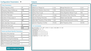

  • Hi Pedrhom,
    Yeah, I understand I have to change the  profileCfg. But when I changed it using advanced design's configuration, the Rviz still showed no image. After calculation, I believe that under this configuration, your frame period (120 ms) is sufficient to accommodate all Chirps (about 4.816 ms is needed). So where is the problem? Is it that the AWR1843boost hardware does not support it?

  • Hello Josel,
    Frankly I do not know who made that the default configuration for 1843 as that was before my time (1843 is over 7 years old now), but there a few weird parameters. Like idle time of 267 and dig out sample rate of exactly 5209. It is a bit odd, and since the values are all over the place in my opinion it would be hard for me to pinpoint what exactly is causing the chirp design to be unstable. I will 100% assure you this is not a device issue, but rather just the full chirp design equation not adding up
    That said, this 1843 configuration attached I approve of much more and should be a much more stable baseline configuration to start with. You will especially notice the values of profileCfg are much less "random".
