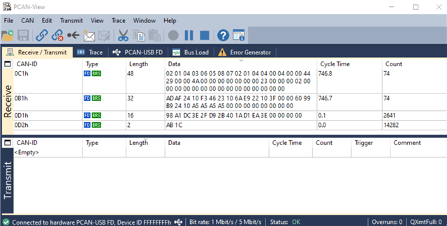

    I have used the same prebuilt binary from the Radar Toolbox that you are testing with. Did you send the CLI configuration?
    This is the data that is transmitted over CAN. I have used PCAN-View to see the data that is transmitted.

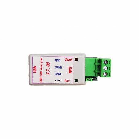

  • Hi Eswaramoorthy,
    Configuration is sent through UART (Application port) and object data is transmitted over CAN. Can you please check and configure the following bitrate?
    Does USB-CAN analyzer support CAN-FD specifications?
    Samhitha
  • Hi Samhitha,
    Yes it is usable for both CAN and CAN-FD but in PCAN view it is not detected.
    Eswaramoorthy Sugavanam

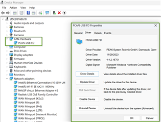

  • Hi Eswara,
    You might not be able to use PCAN-view here since it supports a specific hardware, the USB to CAN analyzer that you are using should have a different software or tool which you can use to configure the nominal bitrate, data bitrate, frequency etc. the above screenshot that Samhitha has shared that is just for your reference.
    Can you share your CAN hardware details visible in your device manager. you will have the following details there
    Also, you have mentioned that the USB to CAN analyzer that you are using supports the CAN and CAN-FD both, have you verified anytime that the CAN-FD is also supported?  I did check the specification of the hardware that you are using, I could not find any documentation or specifications anywhere that it supports CAN-FD. Can you share any reference document of the hardware that you are using where they have mentioned about CAN-FD.
    In our demo and visualizer at present only CAN-FD is supported, so it would be better if we can confirm whether the analyzer supports CAN-FD or not.

  • Hi Shruti,
    Sorry for the mis-conclusion it seems it only supports CAN only let me get a CAN-FD supported hardware, and thank you and sanhitha for the quick responses. let me close this thread.

  • Hi Eswara,
    Please find the hardware details below -
    make sure that there is no bus error during the communication.

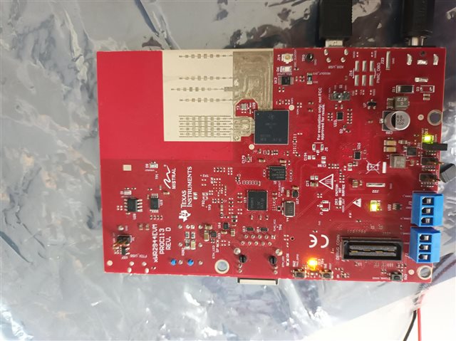

  • Hi Shruti,
    Thank you for the connection photos and I have used the same connection too.
    We have tried with the CAN-FD using pre-built binary and got a error after send cli through teraterm, I have also tried to run the demo with ccs but error remains, can you please check on this.
    after connecting to CAN-FD I am able to see some data pack but after that the above error came
  • Hi Eswara,
    Can you share the screenshot of your setup?
    Shruti

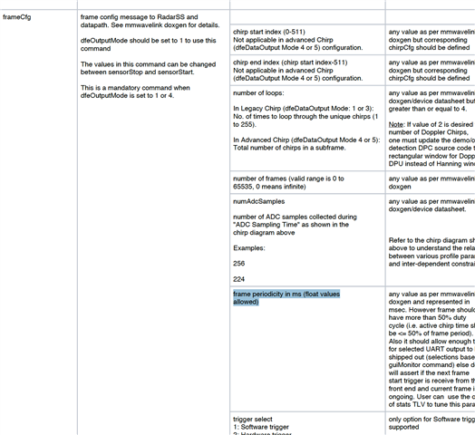

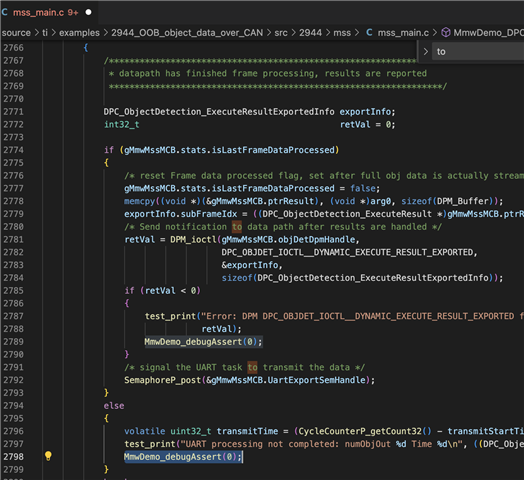

  • Hi Eswara,
    As per error log, issue happens around this line in the code
    That means last frame object data is not streamed out over CANFD within single frame duration and next object data arrived. It could be due to CNAFD capture is not proper on PC side.
    Ideally default application and configuration should work as it worked at Shuri's end during virtual demo.
    Anyways, for quick debug, can your increase the frame periodicity in the CLI command (frameCfg) and re-run the application.
    6th parameter for frameCfg  CLI command in *.cfg file.
