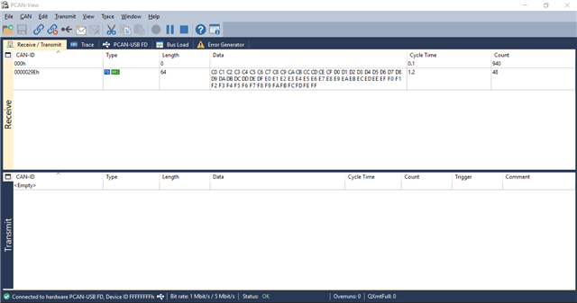

I have tried the OOB data over can project using different version of ccs for example 1220,1240,1260,1270,1271 with SDK version of 4.4.1.2 and radar toolbox version 2.20.0.5, 2.10.0.4, 2.0.0.6, 1.30.1.3 where the error remains the same, I have doubted the installation process what I have done and reset the PC and installed as per the instructions given in api_guide_awr294x, the tried the same process but error remains the same, for hardware connection, I used two different connection for checking.
connection - 1:
CANA_H - CANH
CANA_L - CANL
GND - GND
during this connection state only, I am getting the error mentioned above. and one data packet 0C1h is received.
connection - 2:
CANA_H - CANL
CANA_L - CANH
GND - GND
during this connection state, I don't see any of the data coming from CAN using peak view.

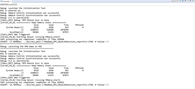

Also for switch cfg S1 - XDS mode, S2 - PMIC SPI mode
also I have tried to run the demo in ccs but error follows
I am sending the cli without enabling heatmap only.

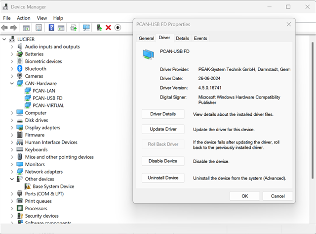

  • Hi Eswara,
    Can you share a screenshot of your device manager's PCAN hardware details.
    Basically, we want to check if there is any driver related issue here. We need to see the following details -
    Check and let us know if you are getting any warning sign here in PCAN-USB FD.
    Shruti
  • Hi Shurti,
    I have attached the screen shot of the driver details
    Eswaramoorthy Sugavanam

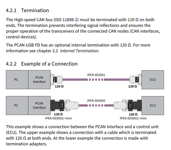

  • Hi Shurti,
    A quick query in the physical connection at TX and RX does the termination of 120 ohm is monitory for stable connection because during the UManual of peak system I have come across a part where is says the peak interface must be terminated with 120 Ohm either internally(peak internal termination) or external care to say does the termination should be connected.
  • Hi Eswara,
    The CAN bus termination is important to prevent the signal distortion and data errors. in our EVM, if you check the schematic, both the CAN buses are terminated properly with 120 ohm.
    Shruti
  • Hi Shruti,
    Thank you for your quick response
    but the connection photo what you shared previously does'nt has any termination connected externally in RX side, does the EVM should be connected with the 120 ohm termination part what I have shared below.
  • Hi Eswara,
    As I said earlier, it's already there in the EVM, why do you need an extra termination? In the dongle side, I assume that internal termination should be there.
    Shruti

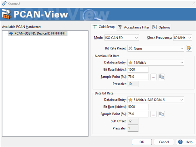

  • Hi Shruti,
    Actually in CAN-FD configuration, I have also tried to see at what spec the MCAN transmitting data in syscfg and found that they're not matching because the nom and data bitrates are not matching with actually spec in code where If I change the sampling point in Nom and data bitrate from 75% to 85% and 87.5, I am able to see continues transmission can you check it once if the syscfg matches in your side. and how to change to 75% sampling point in which you have shown the demo.
  • Hi Eswara,
    Can you share the snapshot of syscfg which you are referring to here?  Also, share the snapshot of that part of the code where you are telling that the configuration is not matching.
    Shruti

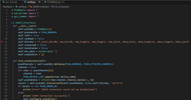

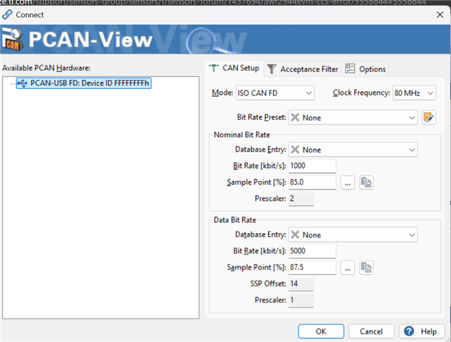

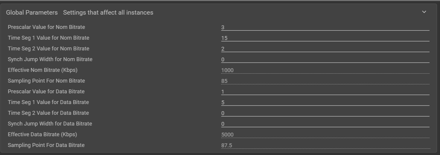

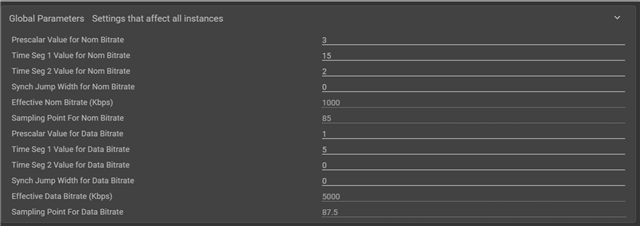

  • Hi Shurti,
    Sorry for wrong info only in syscfg and in Automotive visulizer code, I have seen the different setting I'll attached the screen shot of syscfg and pcan connect setting what I have used.
    Syscfg setting.
    And PCan-View setting

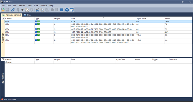

    At the current setting, I am able to see received data in PCAN-view but I am not able to see and data point during running the automotive visulizier can you explain what setting in syscfg and automotive visulizer are different from what cfg you have shared.
    And what is the supported syscfg and pcan-view setting for running in both automotive visulizer and pcan-view.
  • Hi Eswara,
    So now with the sample point modification, you can see the demo data in PCAN view software while running the demo, but not able to plot that in visualizer. Is that correct?
    Can you do the following experiment-
    In the demo mss_main.c file modify the timing configuration, consider the frequency as 80Mhz and modify the following parameter for 1Mhz nominal and 5Mhz data bit rate.
    you can compare these parameters with the test example which I shared previously for reference. after the modification, rebuild the demo and try to run the same.
    If this doesn't work, then you can try modifying these parameters in the visualizer code as per the mss_main.c file.
    Let me know if it works.
    Shruti
  • Hi Shruti,
    I'll try that out but I am bit confused you said the cfg in sampling point are 75% for both nom and data bitrate but how come code from resource explore has 85.
  • Hi Eswara,
    You can use the sample point as 85 and 87.5 for the demo. For the visualizer, I would suggest you to modify the CAN parameter in the visualizer code as per the demo syscfg default settings.
    Shruti
  • Hi Shruti,
    Okey, I'll try it out.
  • Hi Shruti,
    I have made changes in visualizer for specific and got data plotting in visualizer.
