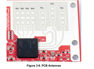

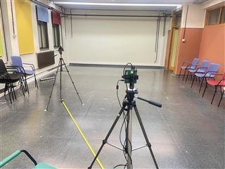

I have some questions about the angle estimation from the raw data.
As the figure shows, I measured a corner reflector on the left hand of the radar.
Figure 1

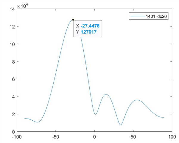

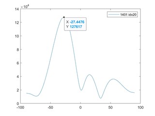

However, when I did angle FFT (513 points) on the corresponding range bin, I got the peak at the negative angle, as the figure shows.
But the antenna arrangement is shown as this figure, so that means when we see the radar board from the back, the antenna layout should be RX4-RX3-RX2-RX1, which also means that I should expect the peak of the Angle FFT appears on the positive angle instead of the negative angle.

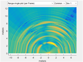

Moreover, when I observed the heatmap from the mmWave studio, we can also see that the strong reflection from the right hand side, which is contradictory to the placement of the corner reflector. And I also checked the MATLAB example, if I calculate the x,y,z coordinate, then I will get the similar thing as the mmWave Studio shows.

  • Hello Bei,
    Are you aware of the virtual antenna mapping of he 6843ISK? This information can be seen on the Radar Toolbox's Antenna Radiation Pattern page for the 6843ISK
    https://dev.ti.com/tirex/explore/node?node=A__AR15ErXW3EPDqIyLkpkGEw__radar_toolbox__1AslXXD__LATEST
    Pedrhom
  • Hi Pedrhom
    I am aware of this, but I thought the mapping figure is showing the mapping when we see it in front of the radar. So when we see from the back of the radar, it should be the opposite order. I believe that this is also how mmWave studio and Matlab Example deal, that is why the range-angle plot is opposite as I expected.
    Bei

  • Hi, Bei:
    When you calculate Azimuth angle, we can use the following 8 antennas because they share the same elevation level.
    [TX1-RX1, TX1-RX2, TX1-RX3, TX1-RX4, TX3-RX1, TX3-RX2, TX3-RX3, TX3-RX4]
    As you mentioned, when the sensor is facing forward, they kinds of switch the order, that is why we assume the index of these 8 antennas are
    azi_ind = - [0, 1, 2, 3, 4, 5, 6, 7]
    Note that we give a negative index for these antennas.  With this index change, you can now follow the regular formular for angle estimation.
    steeringVec(theta) = exp(-1j*2*pi*azi_ind*d/lambda*sin(theta)
    since d = lambda/2;
    steeringVec(theta) = exp(-1j*pi*azi_ind*sin(theta));
    It will be equivalent if you program the above antenna spacing index as m_ind = [7, 6, 5, 4, 3, 2, 1, 0]
    Let me know if it makes sense to you.
    Zigang
  • Hi Zigang,
    Thanks a lot for your reply, and it does make sense theoretically. However, I still have the problem in practice.
    As the above figures show, when I do the simple experiment as the figure shows, I am supposed to see the peak on the right if I just use the index as [0,1,2,3,4,5,6,7]. But now I can see the peak on the left.
    In my understanding, mmWave studio also does the Angle FFT as [7, 6, 5, 4, 3, 2, 1, 0], so I expect to see the strongest area caused by the corner reflector on the left. However, from the screenshot of the mmWave studio, we observed a strong object on the right-hand side.
    That is why I am very confused about the angle FFT part now.
    Bei
  • Hi, Bei:
    Because mmWave studio does not know the antenne layout, we do not usually trust the studio angle results.
    How did you get the spectrum figure in your original post?  To me, the result makes sense, i.e., the target on the left side should have a negative angle.

  • Hi Zigang,
    What I did is TDM-MIMO, and I followed the basic procedure to do pos-processing. I collected ADC Data->find the right Range FFT bin for the corner reflector -> arrange the index as [TX1-RX1, TX1-RX2, TX1-RX3, TX1-RX4, TX3-RX1, TX3-RX2, TX3-RX3, TX3-RX4] and do Angle FFT. So I ended up getting the correct angle without reserving the angle, that is why I am very confused,
    Bei
  • Hi, Bei:
    It really depends on the detail implementation of your DOA algorithm.  How did you do angle FFT?  How do you calculate the angle after range FFT? Did you do fftshift after FFT?
    Zigang
  • Hi Zigang,
    I did Angle FFT after range FFT, and I did fftshit after angle FFT.
    idisbin = 34;
    rangefft_temp = [rangeFFT_frame(iref, 1:1:4, idisbin), rangeFFT_frame(iref+1, 1:1:4, idisbin)]; % for 3 tx
    angefft_temp = fftshift(fft(rangefft_temp,513));
    Bei
  • Hi, Bei:
    Your implementation is correct.  That is how you implement angle beamforming with FFT.
    But if you follow the Bartlett beamforming approach, the steering vector is
    Where you have to use the modified, i.e, azi-ind = [7, 6, 5, 4, 3, 2, 1, 0].  But then you compute your Bartlett beamforming with the formula below
    spectrum(theta)= abs(steeringVec(theta)' * x).^2;
    Where x is your received peak cross different antenna (rangeft_temp in your implementation).
    There is a conjugate above, which kind of flip the sign again.
    Hope it is making sense to you now.
    Zigang
