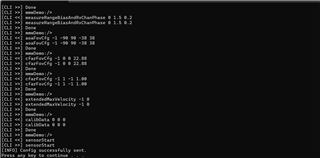

  • With these being my ports
    I switched to COM 14 as you suggested and input the settings you have shown
    The issue remains.

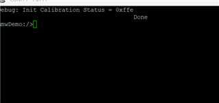

  • When you setup the COM ports in putty, do you see a prompt on the screen?  If you hit enter, does the prompt refresh and give you a new line?  This is sign of a good connection.
    When you 'boot' using. SOP '001' (that is SOP0=1, SOP1=0, SOP2=0) you should see some feedback in terminal upon boot - but that depends on the application image.
    regards,
    Ali
  • Thank you, I can now see what I am sending through the CLI port. However, I am having an issue reading the data from the data port. Is the baud rate the same as the CLI port or is it 921600?
  •  By CLI you mean the UART? Can you share what you see from 'CLI' port.
    Are you trying to run the visualizer in the OoO Demo?  Is that when you don't see data?
