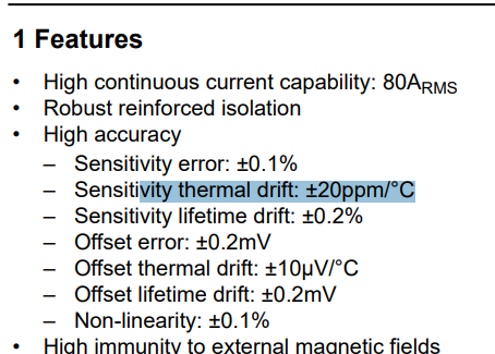

The sensitivity thermal drift shows +/-20ppm/degC, it means
20ppm/degC= (20/1e6)*190*100=+/-0.38%.

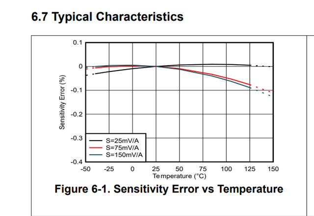

But the fig 6-1 shows it is only -0.1% error.
What's different?
What's different?
Thank you for your post.
The plot you are referring to is the plot over temperature of the sensitivity error (%) and the 0.1% error is the 25C typical error.
I made an excel error calculator tool that you can see the effects of both the sensitivity error and the sensitivity drift.
Please also take a look at section 9.1.1 for example error calculations.
