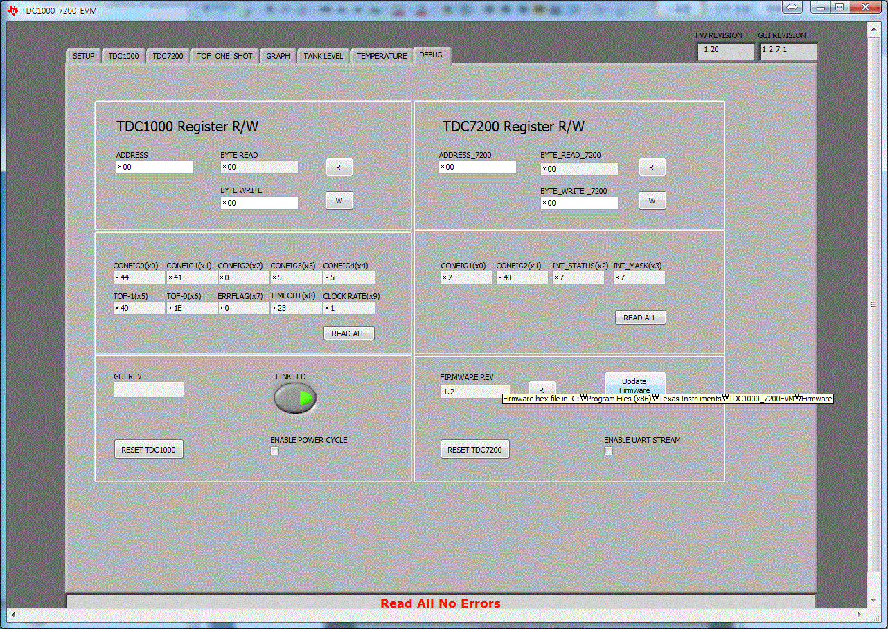

I got the evm last week.

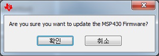

I intalled the GUI software and run it.
I see the pop-up like this.
So I goto the debug menu for update the firmware.
But I can't find a new firmware at your homepage.
How can i get the new virsion?

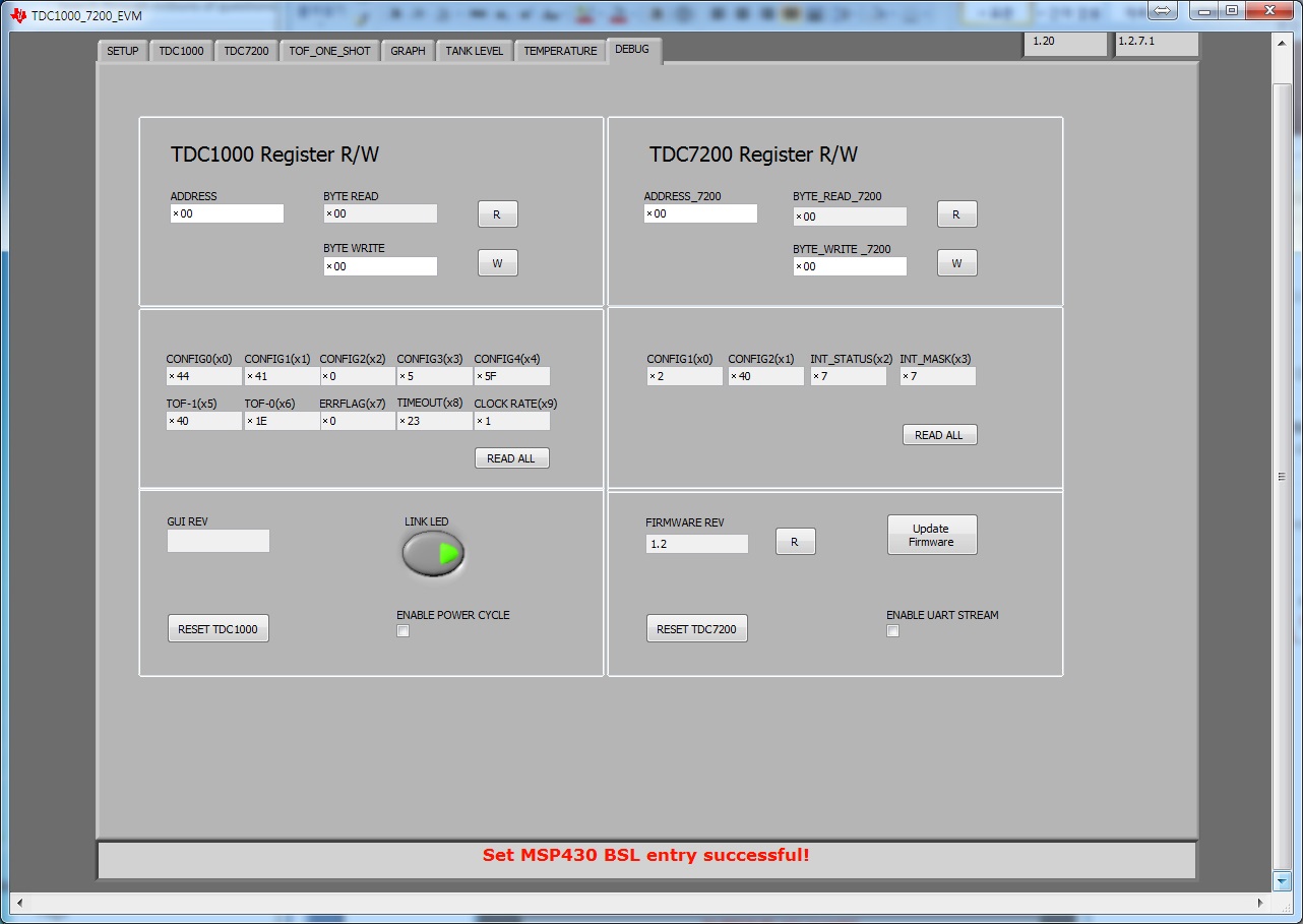

  • I received the answer.
    So I try again, but it doesn’t work.
    See below.
    What’s the next step?

    b) You should disconnect and reconnect the EVM while holding the SW1 button down so the MSP430 device is in BSL mode for firmware upgrade. You should see the "Found 1 device" message as shown in the screen capture below.
