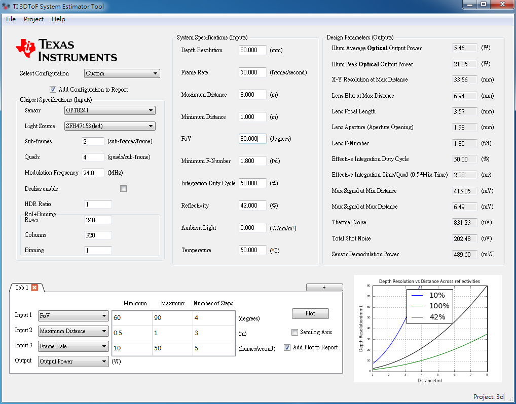

    Here is the screenshot of ToF System Estimator tool:
    I can not use larger aperture lens due to cost issue, I just choose a universal lens in our industry.

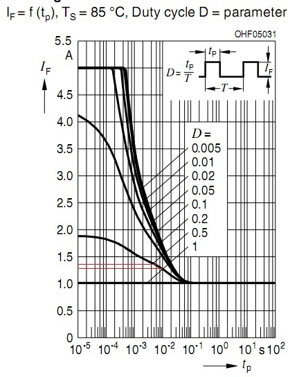

    Running the LEDs at 50% integration duty cycle, you should be able to get optical peak power of more than 1W per LED. Please refer to the duty cycle vs peak current data on the  datasheet of the LED.
    And I also see that your range is 8m. Are you aiming for an outdoor application? If you expect the camera to work  in sunlight, you would have to account for ambient light in the system estimator tool.

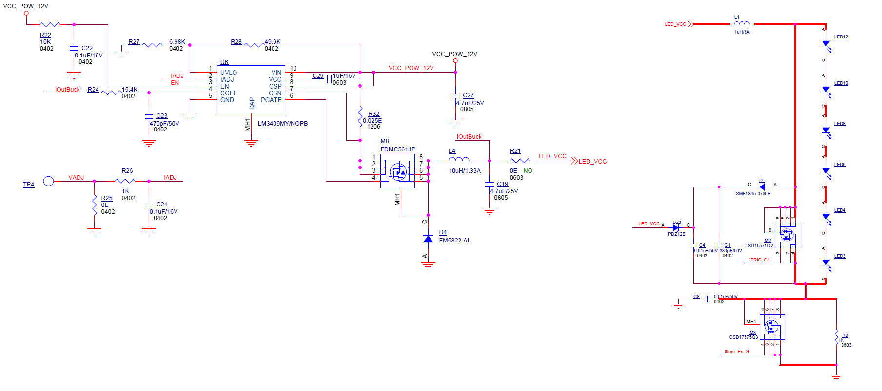

  • Hi Subhash,
    Could you please help to check attached LM3409 circuit?
    It doesn't work, I don't know what's wrong.
    Thanks.
    Best regards.
    Eric
  • Hi Eric,
    I missed out on responding to this thread. Can you tell me if this is working yet? If not, can you tell me what are the conditions and symptoms?
    Few issues that I notice with this circuit:
    1. EN pin of LM3409 is pulled up to 12V. So if the sensor board is not powered, but the illumination board is powered, it will cause the ILLUM_EN pin of OPT8241 to break down due to 12V input.
    2. M3 is being controlled with ILLUM_EN. When M3 turns off, it will suddenly stop all the current. The combination of D1, D2 will work as freewheeling diodes for inductor L1. L3 would still try to force current through and may end up damaging some part of the circuit. Did you see that the circuit was not working from the start or if it worked for a few seconds and then stopped working?
    3. Can you try replacing R8 with a 0 ohm resistor? that should resolve some of the problem
    Subhash
