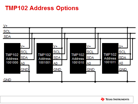

I saw the datasheet describe that TMP102 could contact A0 to with SCL and SDA for different address
Could you provide the reference design schematic for these 4 different kindly of address
Do to we have a little confuse if we contact A0 to SCL or SDA and pull up 3.3V ,TMP102 still can communicate with MCU
