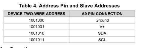

TMP102 has different I2C address when A0 is connected to different pins as shown in the picture below.
What kind of circuit internally is used to have this function? Is there any app note about it? Thanks.

    There is no app note describing the circuit. When connected to SDA or SCL, the TMP102 monitors the change of level to decode the slave address. At the time of a valid transaction start, if the A0 pin does not change then GND or V+ is decoded based on the level. If the A0 pin changes, then it is compared against the SDA or SCL to decode the address.

    If it works as described, will the first immediate read or write command become invalid when A0 pin is connected to SDA or SCL? Because it takes time to monitor the voltage change on A0 pin.
    So when we program to read or write, do we give extra time to let TMP102 to decode its address?

    No the first read or write command will not be invalidated, as the address bits do not move in till the first SCL, whereas address mapping would be detected earlier than that.
