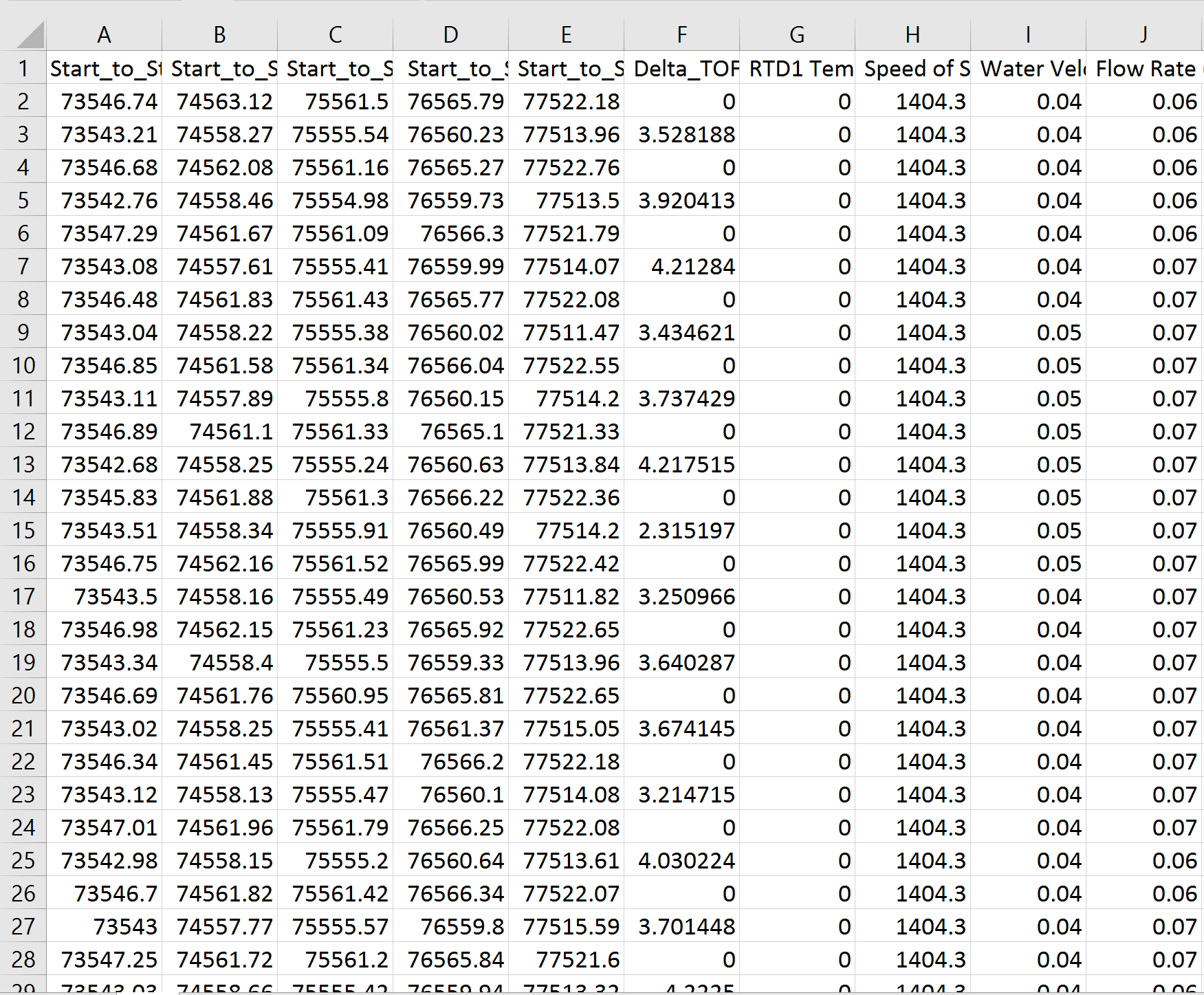

I am attempting to use the TDC1000-TDC7200 EVM in a flow metering application, but not in a pipe. Rather, it is to be used in an open tank environment and later in the ocean. To achieve this, I have used these pre-potted sensors: https://www.steminc.com/PZT/en/food-grade-ultrasonic-flow-sensor-1mhz. I have press fitted these into a delrin frame that my coworker created like so:
They are flush with the edge of each "mast" and each sensor is run through a small coaxial cable to suppress EMI. The basic functionality of the board is present, however, I'm noticing a disparity between the upstream and downstream TOF causing a delta TOF of around 4 ns at zero flow. Here is a sample CSV file run in flow mode:
As you can see, there is a near-constant delay between the upstream and downstream TOF measurements. Next, I will attach screenshots of my GUI tabs, and what I read on my THS3024 Oscilloscope:

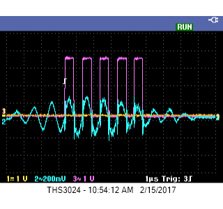

There is also a bit of strange ringing right before and during the START pulse for me, which I can't explain.
Please let me know if you have any ideas for how I can solve this problem. I suspect it may have to do with the mounting method, but I'm not sure. Perhaps I'm overlooking some specific setting.

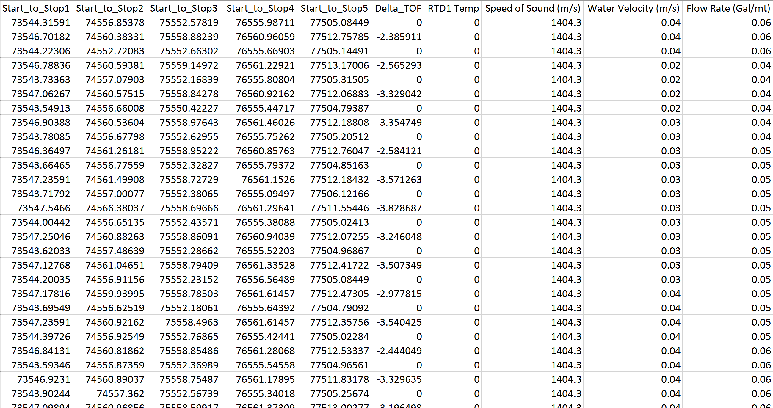

  • Hi Scott and Vishy,
    Thank you for the suggestion on the FORCE_SHORT_TOF field. I was misunderstanding the parameter. This fixed my "early ringing" problem, but unfortunately, this didn't solve my main issue. I will attach images of the new scenario as well as my current config files.
    Also, I'm wondering why the COMPIN signal seems to be so noisy only when the STOP pulses start. Could this be crosstalk? A faulty board? Or maybe just my scope? I'm planning to switch to coax scope probes this week, like in the demo.
    Here on the GRAPH tab is
    1) Mode 2, oscillations due to upstream/downstream disparity
    2) Mode 1, Channel 1
    3) Mode 1, Channel 2
    4) Back to Mode 2
    You can see that the upstream and downstream values are directly correlated to the oscillations in Mode 2.
    The config files are attached below. If you have any more suggestions for how to fix my issue, please let me know. Of course, I am happy to answer any more questions you may have for me.
    Jordan

  • Hi all,
    As a quick update, I switched to BNC scope probes and the COMPIN noise is now gone. However, the upstream/downstream discrepancy remains.
    I look forward to hearing back from you when you know more.

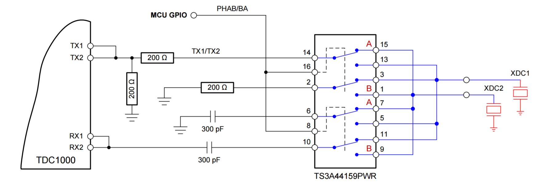

    In the meantime, I was wondering about something. In the document you linked in your first reply, there are several mentions to a "Texas Instruments sensor interfacing circuit" and then a picture with this schematic.
     Excuse me if this is a bad question, but is this circuit included on the EVM? I saw no reference to the switching chip shown here. If it is not already on the EVM board, can I assume that this circuit may solve my problem if it is indeed due to some sensor mismatch?
    I look forward to your reply,
    Jordan
  • >>>Excuse me if this is a bad question, but is this circuit included on the EVM? I saw no reference to the switching chip shown here. If it is not already on the EVM board, can I assume that this circuit may solve my problem if it is indeed due to some sensor mismatch?
    That circuit is not on the EVM. I enclose a document that summarizes our experiments with such a board to improve performance when using audiowell flow sensor pipe. As you can see the setup we have used to test with is different. I also enclose the config file used.
