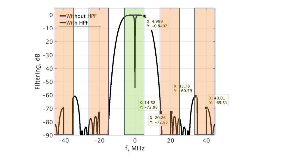

    The full scale signal corresponds to 1V at the ADC input. So depending on your configuration (12/14/16bits) the swing corresponding to the each LSB would change. You can back calculate the signal from ADC voltage to LNA input by multiplying the RX chain gain that is set.
    The anti aliasing filter is adjusted based on the sampling rate configured. The pass band allows a bandwidth of 90% of Nyquist frequency. ie 0.9*(fs/2) in case of real mode and 0.9*fs incase of complex 1x mode.
    Below is an example filter response with a 10Mbps sampling rate (real mode).
    Vivek

    The AWR1243 supports 12/14/16 bit options. You can use either of the three. The ADC impedance , single/differential design etc. are our internal design details which we cannot share.
    There are two HPFs and each of the HPF has 20dB/decade rolloff beyond the corner frequency programmed by the user.
